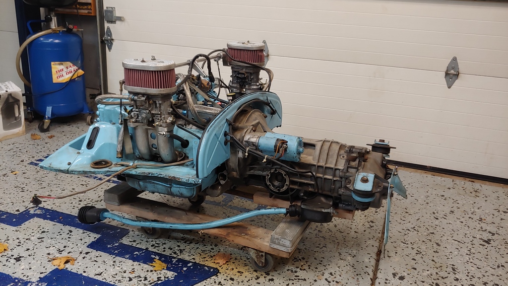

Engine out
(IMG:http://www.914world.com/bbs2/uploads_offsite/i582.photobucket.com-21387-1547084992.1.jpg)
Got the engine disassembled down to the case for the most part.

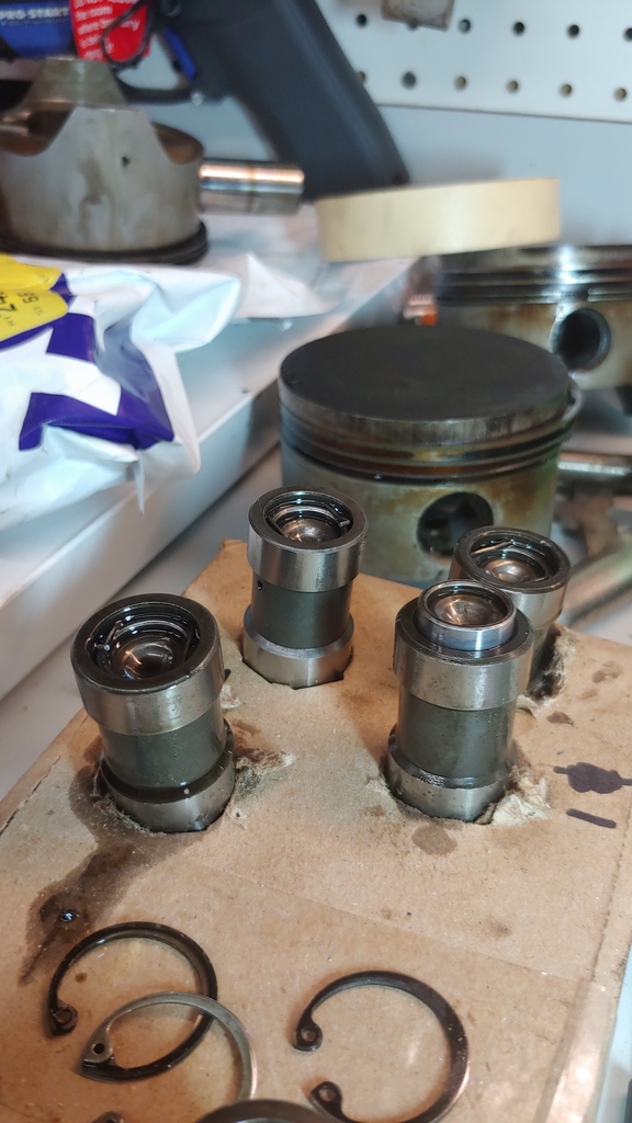

(IMG:http://www.914world.com/bbs2/uploads_offsite/i582.photobucket.com-21387-1547084992.2.jpg)
Noticed that the lifters are bad. One was missing the retainer spring as per the picture below. This just so happens to be the same cylinder that had a bent push rod. Coincidence, I think not.

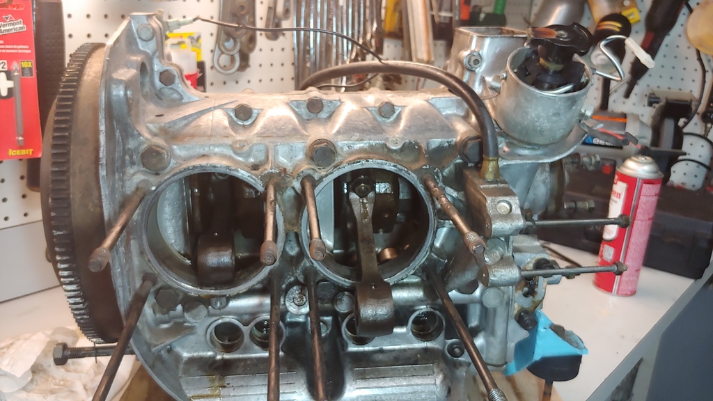

(IMG:http://www.914world.com/bbs2/uploads_offsite/i582.photobucket.com-21387-1547084993.3.jpg)
Now I need to buy some parts so I can split the case replace the cam and start the rebuild process. Some questions I was hoping you guys can help with:

Dump the hydraulic lifters...

I built mine with parkerized solid lifters and hand cut a set of chrome moly push rods.
I also used 911 adjusters.
I keep the D-Jet.
Hydraulic lifters steal horsepower, they can collapse and cause a push rod to bend.
Better for buses than sports cars. They need a hydraulic cam.
