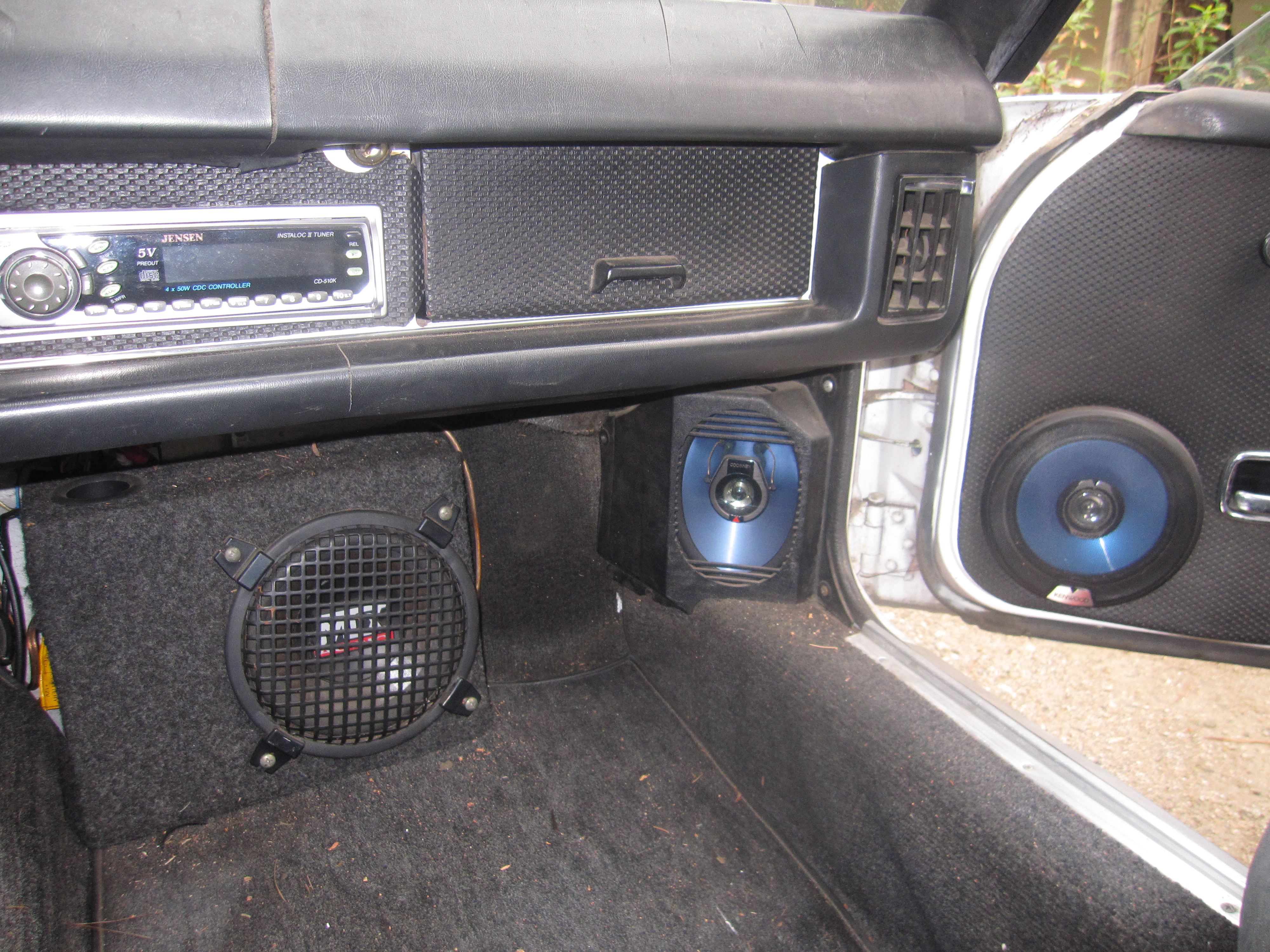

I made this one, with a dedicated power amp for the sub and four other speakers it's probably over kill for a concert hall the size of a 914 cockpit. (IMG:style_emoticons/default/biggrin.gif) Attached Image

QUOTE(Jonathan Livesay @ Jan 29 2019, 03:29 PM) *
What size in the factory speaker boxes?? Very interesting...
