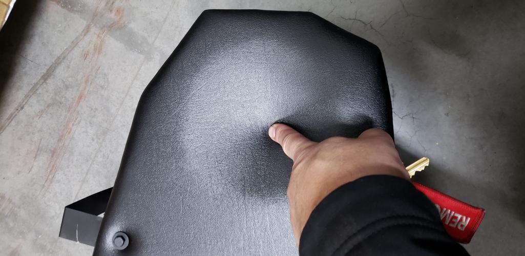

First, where should the speaker go????
Wow - no particle board - furniture grade ply!
Peel back the Vinyl, careful!
Counter sync for flush hidden finish
Score the vinyl, perhaps we can STRETCH it!
Heat gun and PULL, gently
Look at that circle, no wood showing, barely a wrinkle!
Add a screen
Bolt that Micro SubWoofer in place
What the Passenger will see
Perfect Fit
Passive Crossover
Will post a note as to how this sounds in a few weeks (months?)
