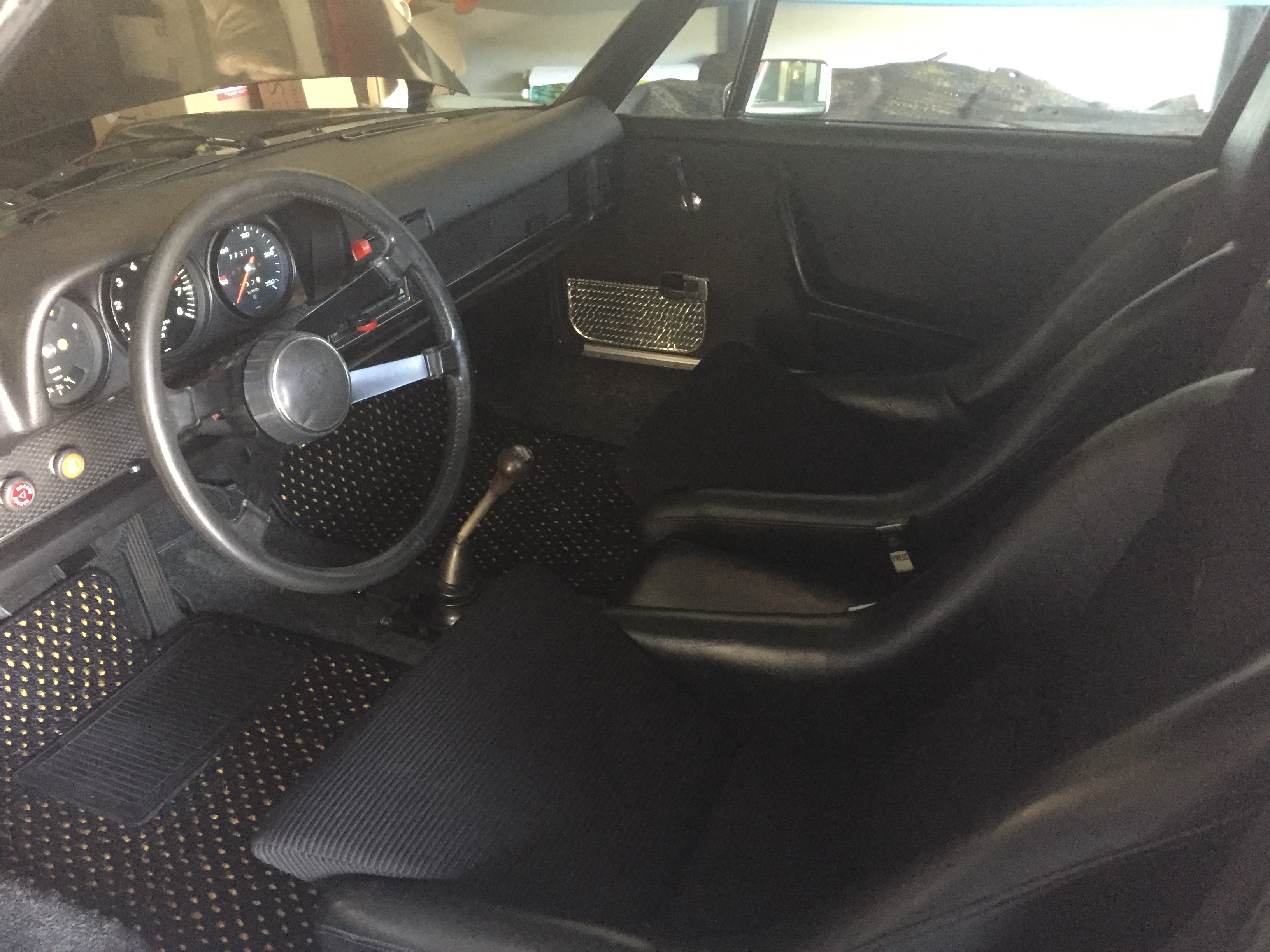

wes   Did a dry fitting and all is good perfect fit on r...   Jan 28 2019, 09:16 PM
