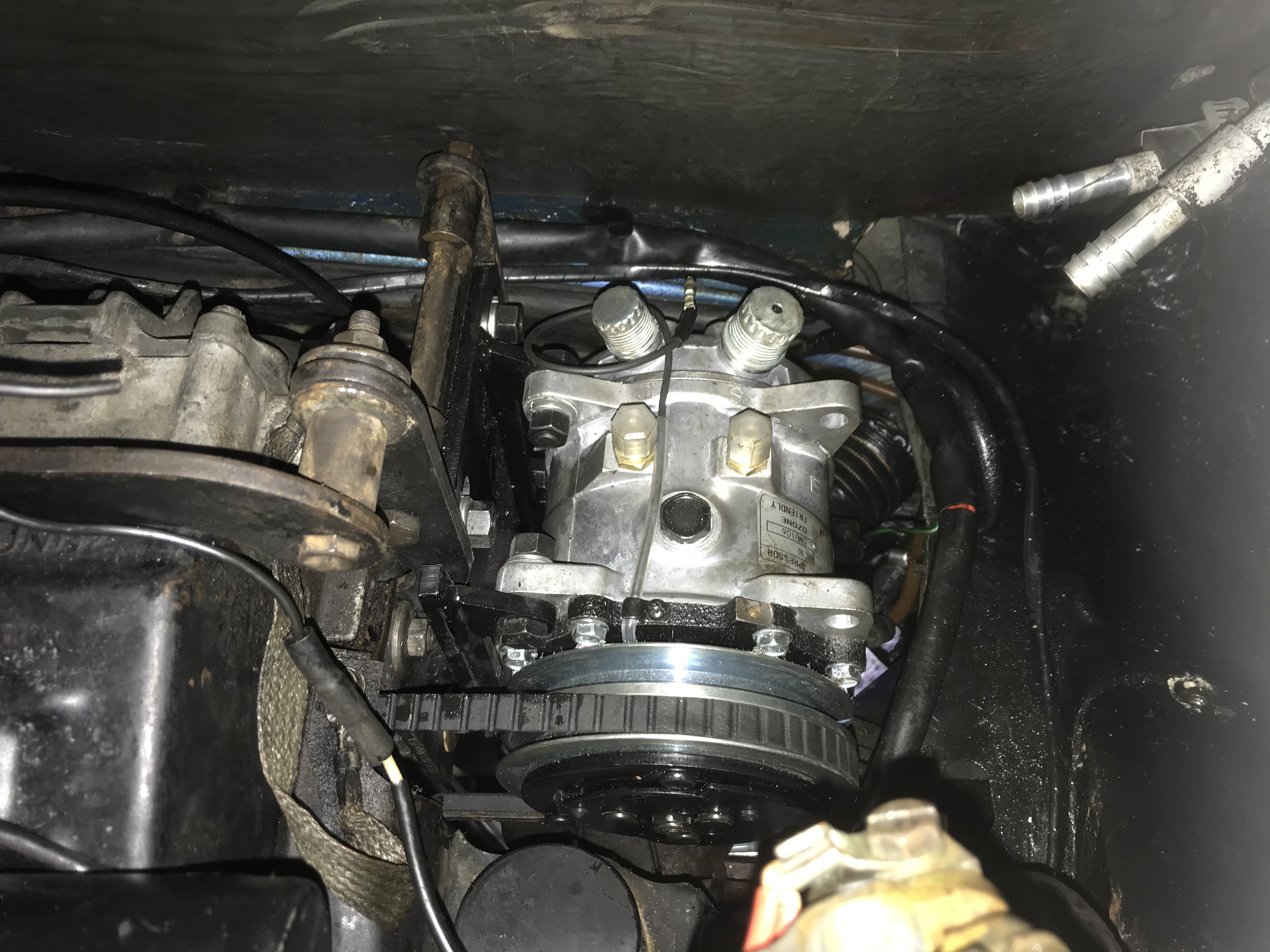

For anyone using this for reference as I did. My car has the VPC system. I got a Sanden 505 and York to Sanden bracket. I had to cut a slot in the bracket to make it work but it put the pulley almost in the exact same location. I got the stock size belt to fit but it is tight with none of the adjustment spacers installed. I would have purchased a one inch longer belt had I known. Now I just need to replace the hoses and charge the system.

jdamiano   Oh and another thing I learned. I noticed the brac...   Feb 3 2019, 06:29 PM
jdamiano   Here is the belt I used. It worked but was tight.   Feb 3 2019, 08:24 PM
