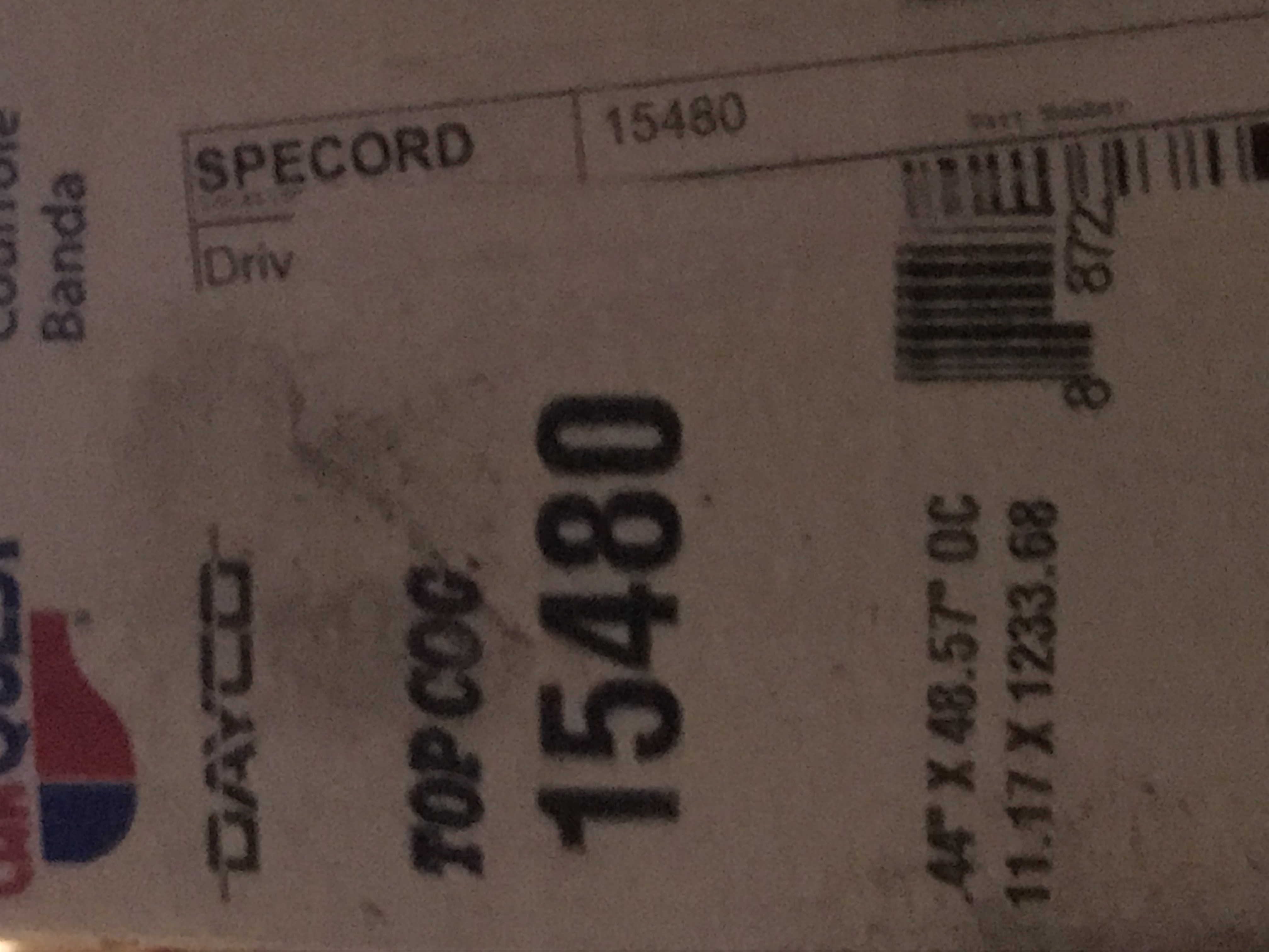

Here is the belt I used. It worked but was tight.

jdamiano   Here is the belt I used. It worked but was tight.   Feb 3 2019, 08:24 PM
