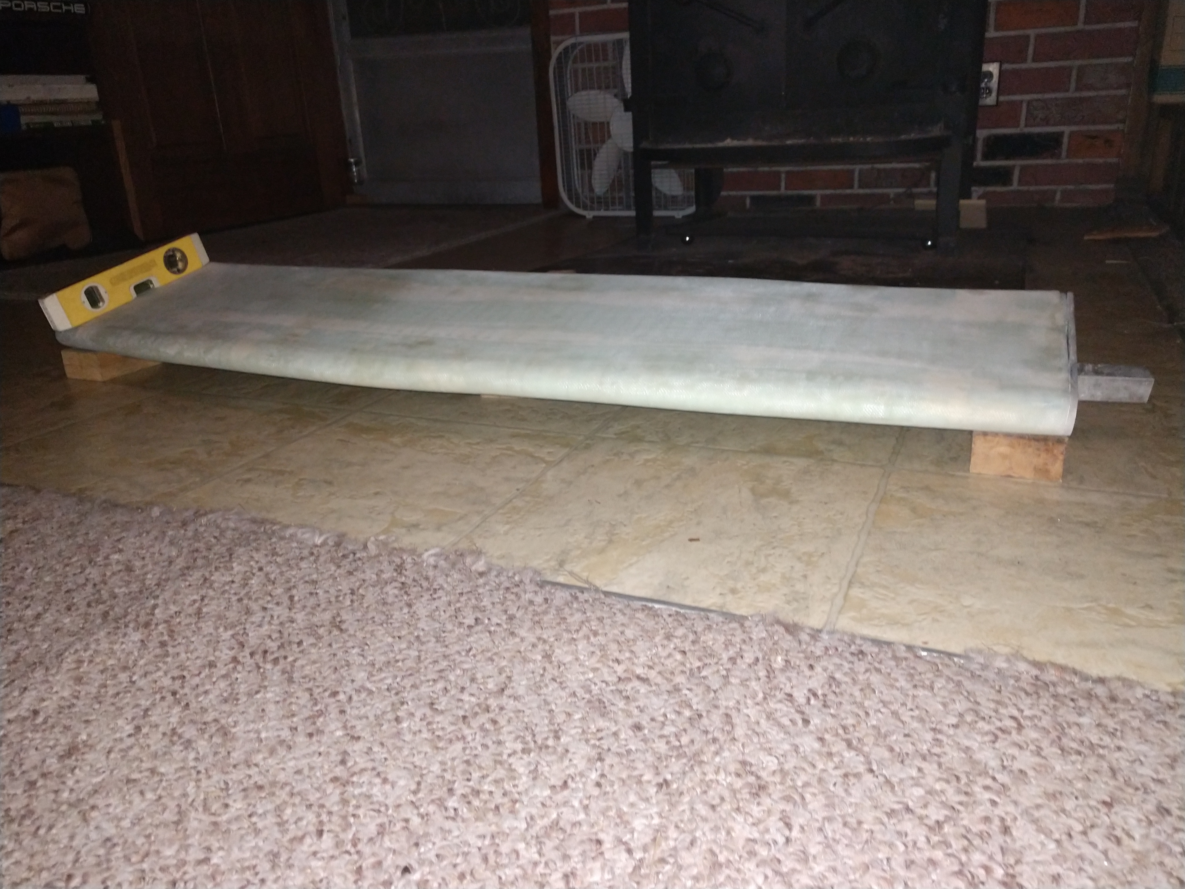

Yesterday I blocked the front foil up on the floor just to check it out. I put it about 2" off the floor tilted at about 10° and the leading edge is parallel to the ground. I stole the line for the beam from the front hood. I measured 10.5" up from the front edge which is just above the headlight well and drew the line.
Kind of tough making a compound curved square tube round would have been much more challenging. The foil has a little twist in it (about1°) but it is from not looking close enough before gluing all the foam pieces together. You'll never be able to see it when it's done.
