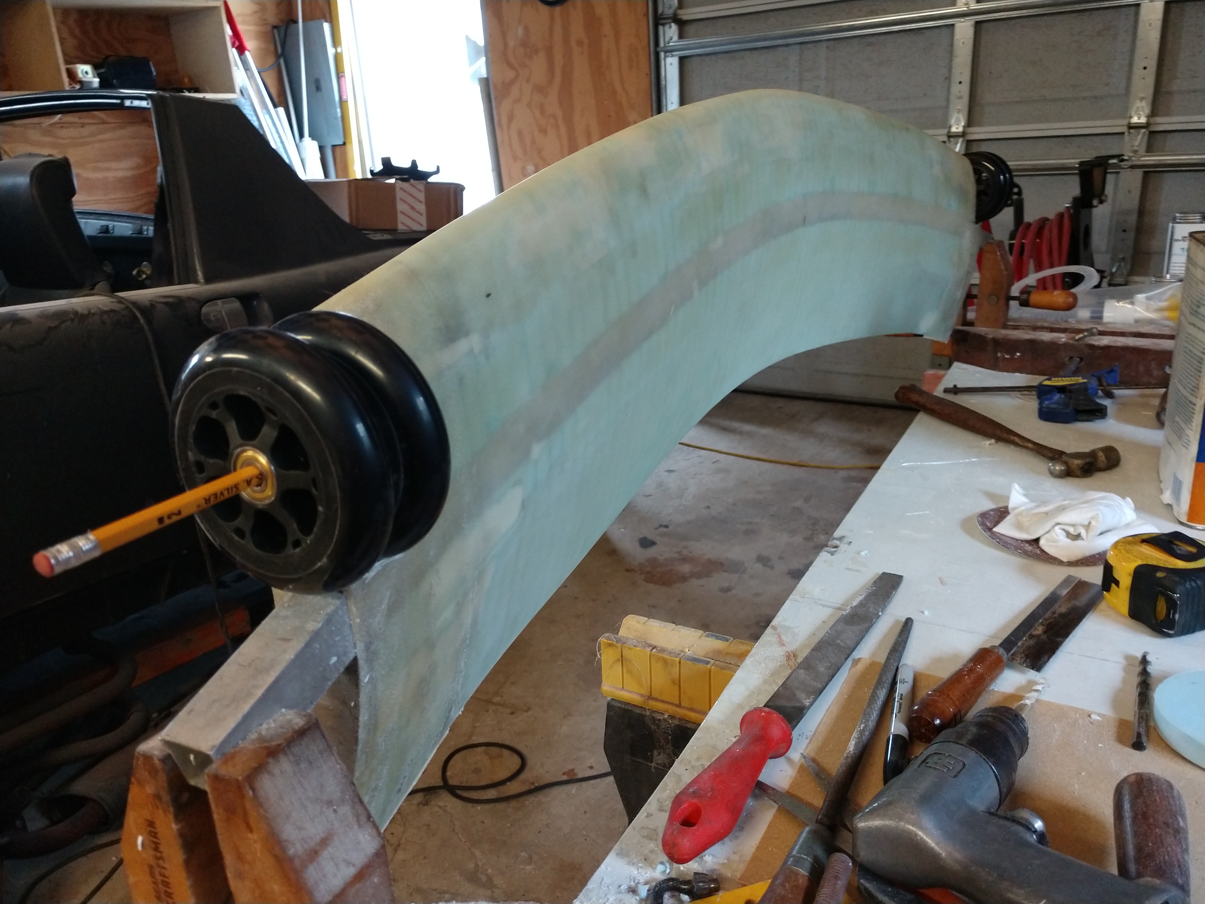

Not much but I did make the cut out for the right side wheels.
Right now I'm looking for a way to make a bump in the fiberglass.

914 Ranch   The wheels arrived so now I am installing them. I ...   Feb 18 2019, 05:15 AM
914 Ranch   Not much but I did make the cut out for the right ...   Feb 20 2019, 02:45 PM

914 Ranch   Got the wheels mounted. A few more layer's of ...   Feb 22 2019, 04:21 PM
stownsen914   Are the wheels to protect the wing from hitting th...   Feb 23 2019, 08:49 PM
914 Ranch   Yes, I plan on mounting the wings nose 3" off...   Feb 24 2019, 02:28 PM
914 Ranch   Apparently I like to do things twice.   Feb 27 2019, 07:20 AM
914 Ranch   I've come to a dilemma about the wings. The ta...   Feb 27 2019, 07:24 AM
stownsen914   For the wheels on the front wing, just make sure t...   Feb 27 2019, 01:29 PM
914 Ranch   I was thinking that it needs to have a pivot and s...   Feb 27 2019, 04:34 PM

914 Ranch   Working on the brackets today. Some progress. F...   Mar 4 2019, 09:52 AM
914 Ranch   More of the Swansneck, got the rough patterns done...   Mar 5 2019, 03:01 PM
