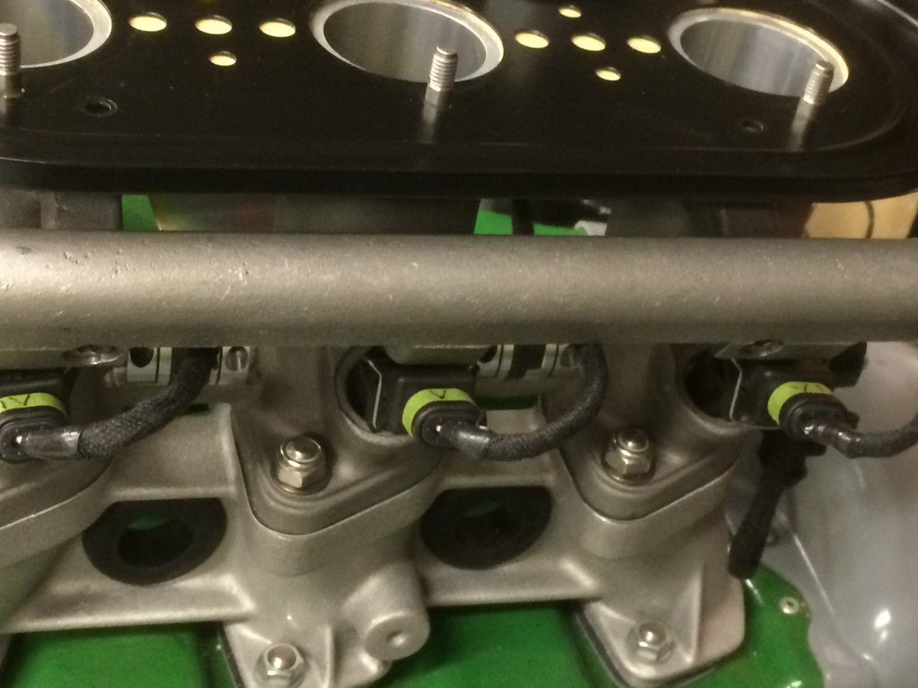

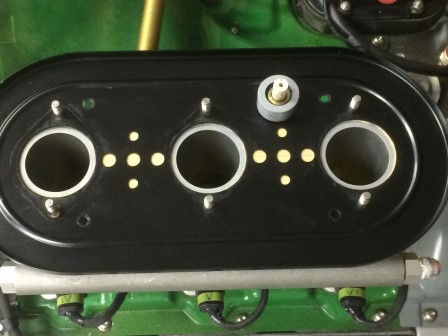

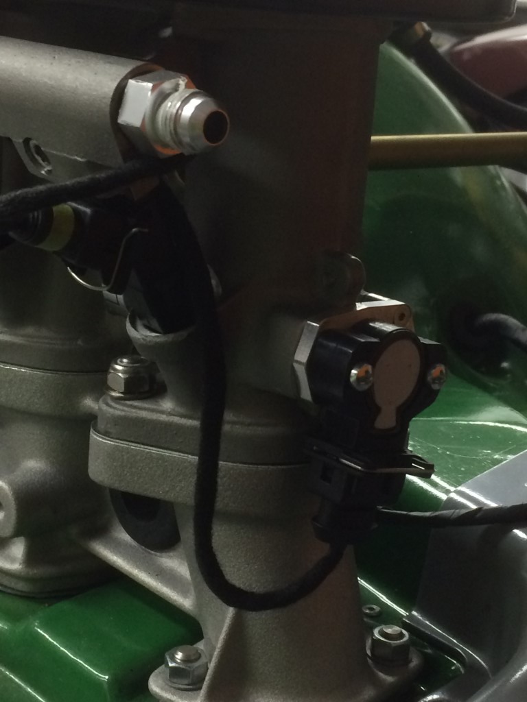

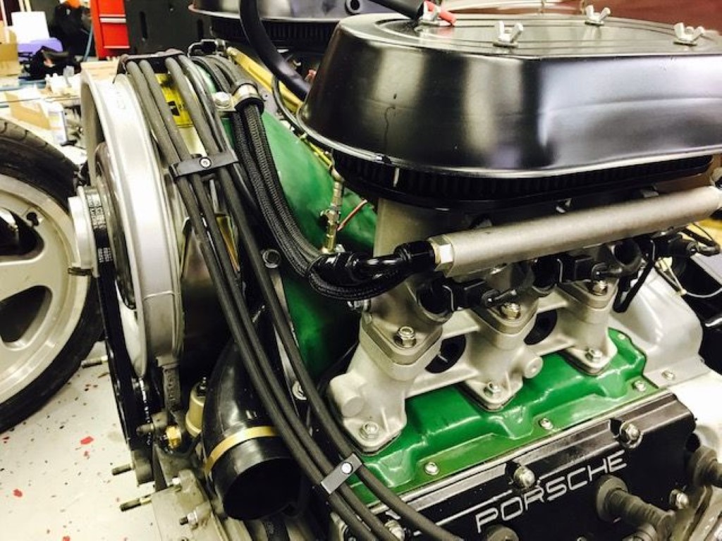

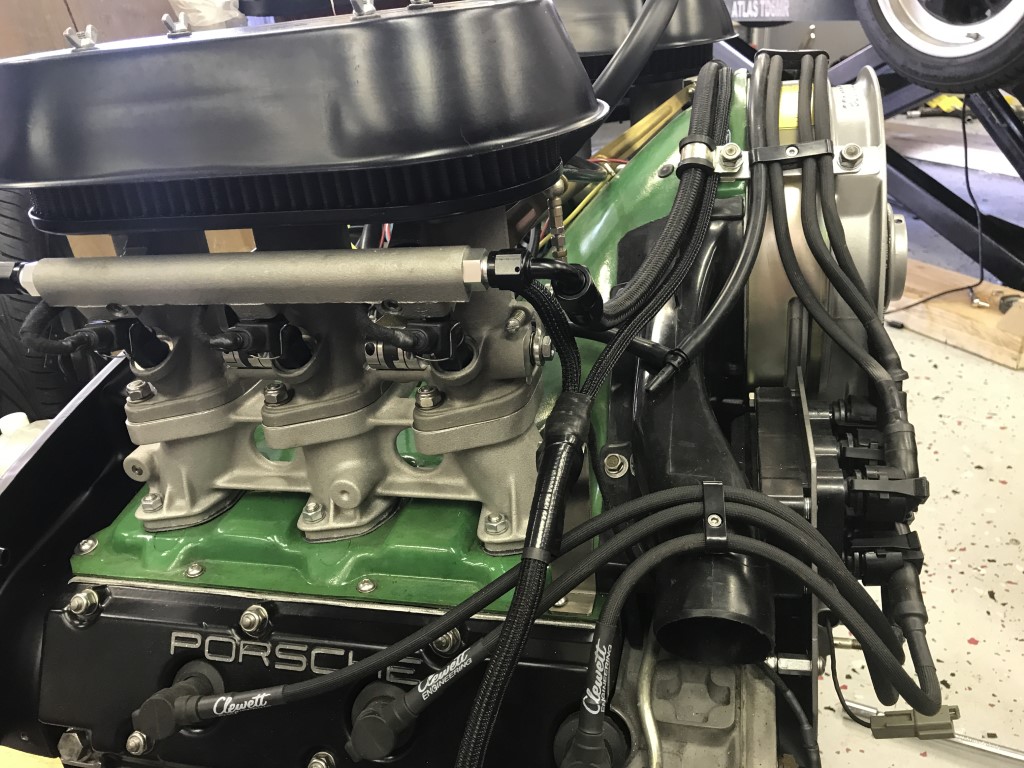

So I completed the wiring for the engine sensors, the EDIS, and the injectors. MS3x can handle sequential injection management but for now, I’m going to go with batch fueling for each bank. I can always come back and modify it later if it seems I need to.
Attached Image Here's the air temp sensor on the bottom plate of the rain hat,
Attached Image The throttle position sensor,
Attached Image The fuel injectors at the base of the 40mm throttle bodies,
Attached Image The roughed in wiring, and
Attached Image The final wiring.

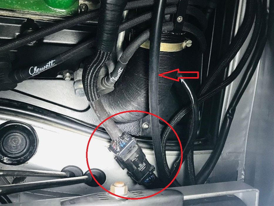

Attached Image The FI engine connector and the manifold vacuum line.
After getting the engine to this point, I re-evaluated the connector for the engine electronics and decided that I could go with a smaller connector. This is for the engine to ECU harness and again, not wanting to cut/drill any holes, this was a good decision. The braided harness coming off the engine between the 1st and 2nd pugs in the pic above goes to a 16-pin connector so that when I need to drop the engine, I'll only have 3 connectors, the battery cable, and a fuel line to disconnect, keeping it pretty simple and straightforward.
