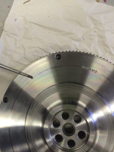

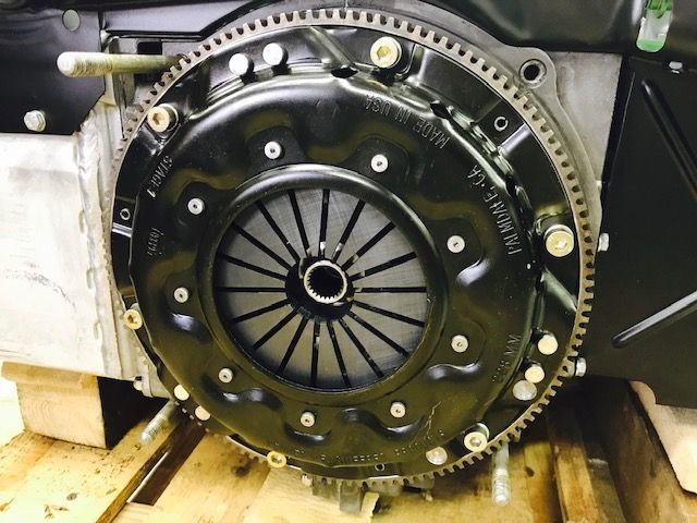

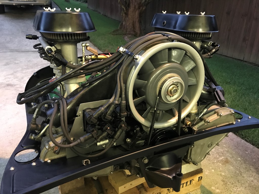

The next issue was to add the new clutch, pressure plate, starter, and a side-shifter trans in place of the stock tail-shifter as another step to make the car a little more fun to drive.
I reached out to Kennedy Engineering and got one of their 228mm Stage 1 bus kits (flywheel, disc, pressure plate) and a new throw-out bearing and transmission input shaft seal while I was in there. This package is supposed to be able to handle up to 300HP with a pedal pressure similar to that of the stock. When I first bolted up the flywheel, I noticed that I couldn't turn the engine over with a wrench so I then backed off the torque on the bolts to hand tight, and I could turn the engine again but heard something dragging....
Attached ImageAttached Image

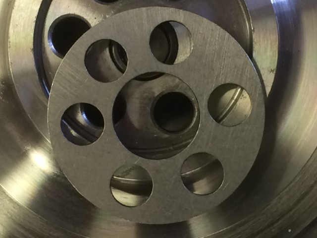

Just so you know, there is a spacer that goes in between the flywheel and crankshaft (if you look at the manual, you'll see it there but I didn't want to cause questions/concerns here by not showing it).
So I called Kennedy and shipped it back out for "a little bit more machining". While it was out, I got a second set of factory -6 engine sheet metal powder coated. I have the gun and oven to do smaller pieces but the longest piece across the front of the engine is too long to fit in my shop oven so I found someone locally. It looked nice pulling it all together for the first time.

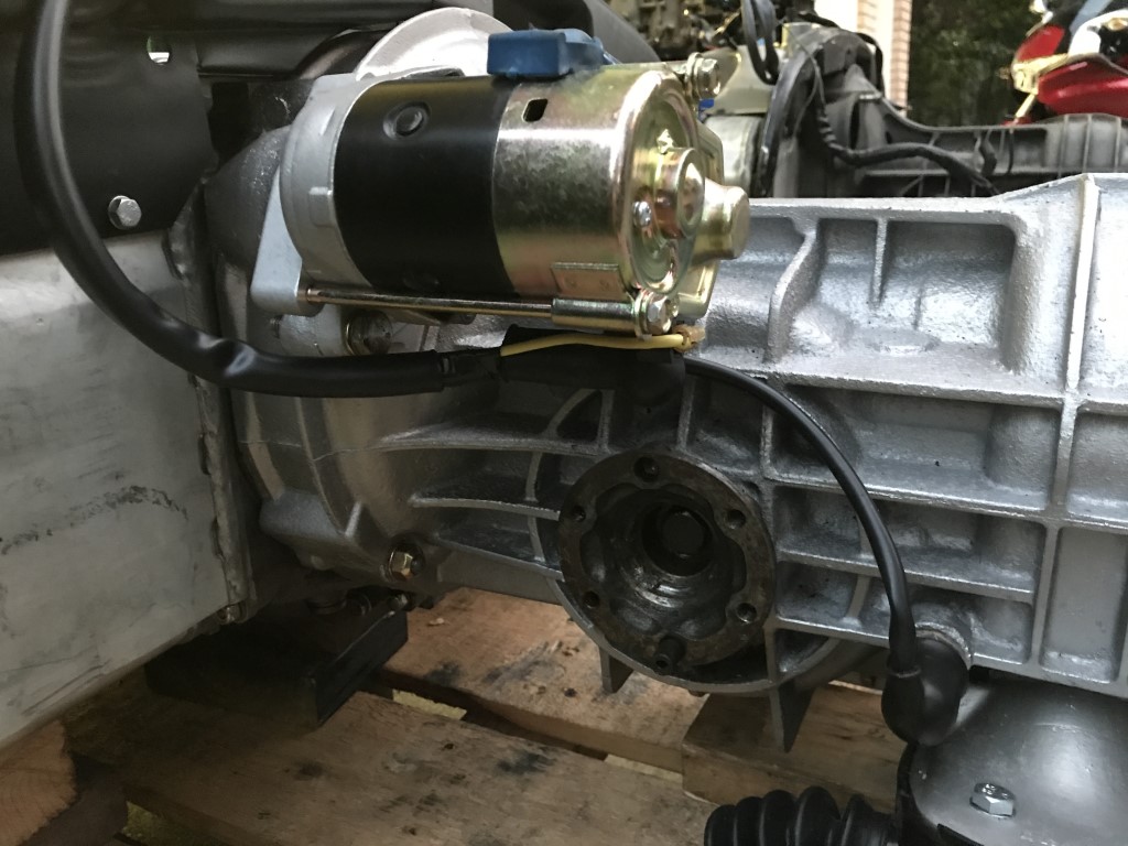

When I got it back, it went on without a hitch so I was then able to bolt up the side-shifter trans that I had cleaned up some and the new starter so that I could finish the engine wiring harness.
It took me a long time to get all of this pulled together, having never done this before. I learned A LOT reading through the threads here and that really helped, along with bolstering my confidence just enough to try this. As with documenting any project like this in hind-sight, there is a lot I'm skipping over....too many little details to bore you with.

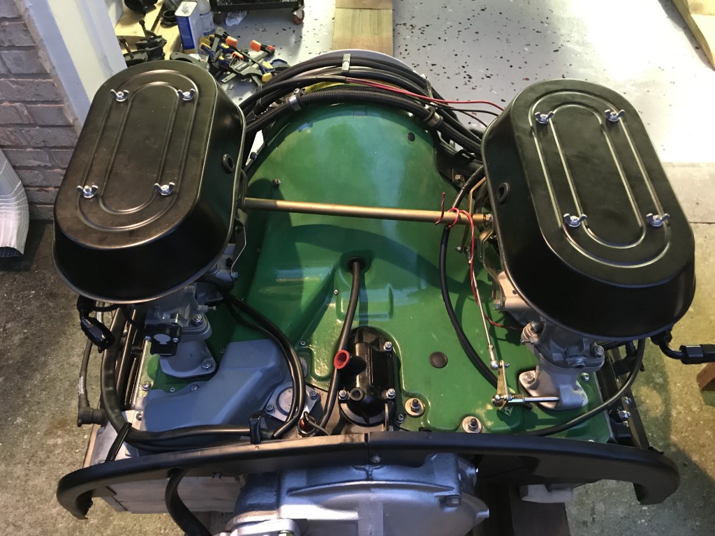

If you look just behind the rain hat on the left, you'll see the 45degree elbow for the fuel line. The fuel circulates from the tank, through the fuel rail on the #1 bank from the rear (see 90 degree elbow behind the rain hat on the right in the pic), across the top of the fan housing to the driver's side bank, past those injections, through the elbow you see on the left in the pic, and then into the PMO regulator mounted at the back of the engine compartment above the engine/trans mating surface, and finally to the return line to the tank. The regulator is set at 43-44 PSI.
