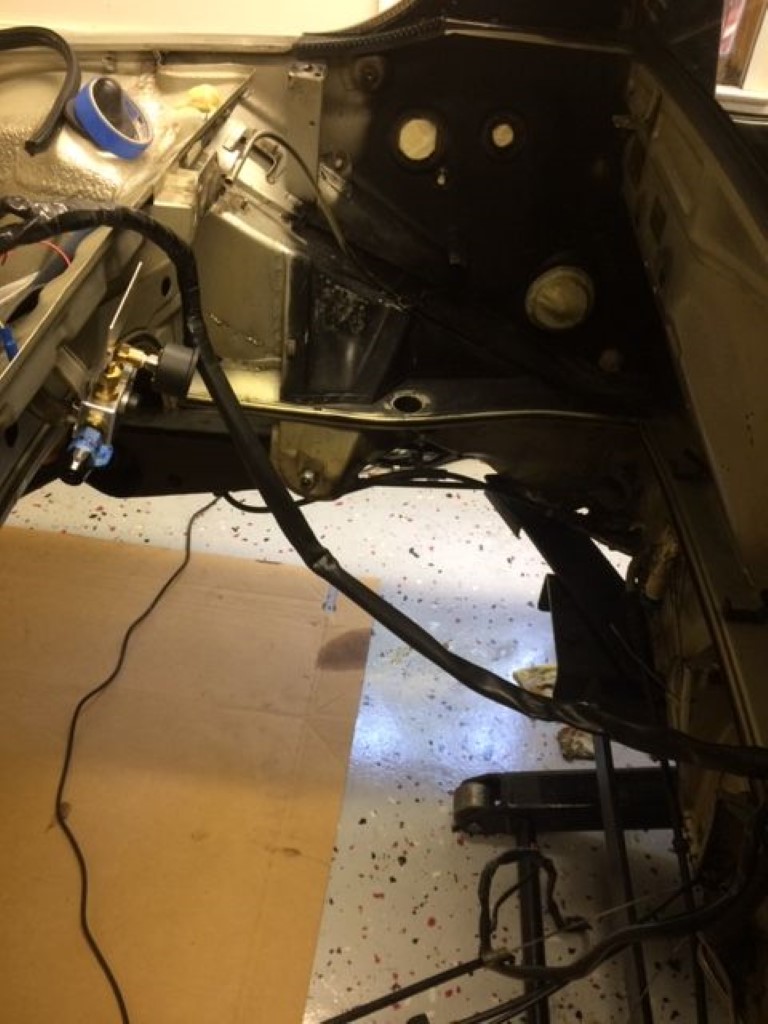

As I continued chasing the crunchy wires in the engine compartment to the light, I decided to continue working on back through the harness in the trunk to check that wiring. I pulled it loose and find some issues here and there so I got some of the fabric harness tape from 914Rubber and dug in. I pulled it all loose and examined the wires and decided to make some repairs using part of another trunk wiring harness I had from a parts car. I carefully cleaned the wires and then carefully started to wrap it back up. When I finished, I was pretty happy with the results but then looking at the trunk, I really couldn't see putting the fresh harness back into that trunk.

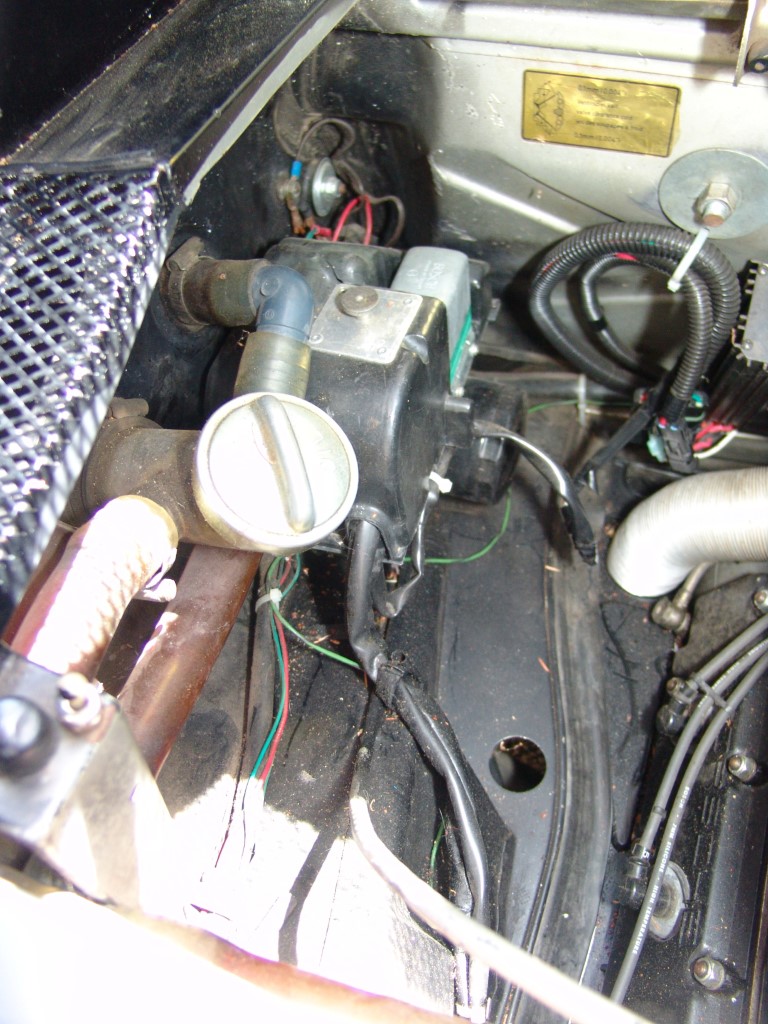

Here's some of what I saw from the PO:

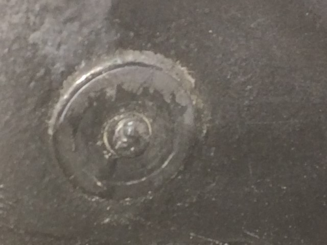

At some point, the PO decided to spray part of the engine compartment with black spray paint.....oh yea, and the 2" washer and bolt in the firewall, there were four of them, hardware-store grade, mounted in the firewall for a 5 pt. harness system. And the bolt holes weren't even in a straight line horizontally across the firewall.

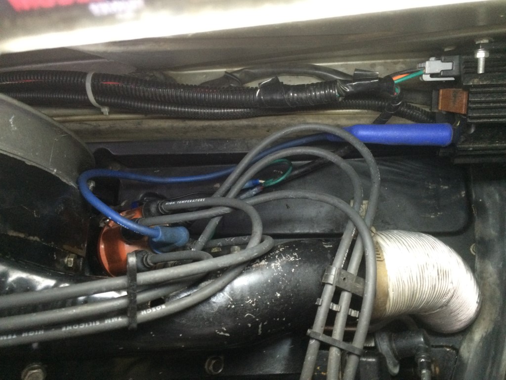

He had also added some Crane High Energy/Mallory ignition system and had wires and components mounted on both sides of the fan on the firewall...

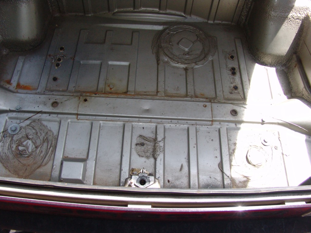

And then there's the trunk....lots of holes from various mounting of a rear sway bar and the holes in the rear panel for the "Porsche" reflector.
