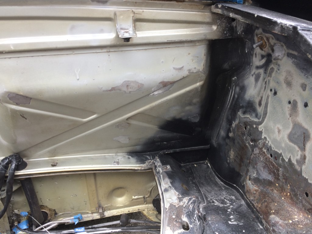

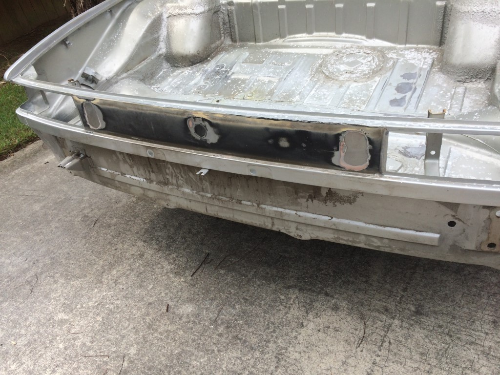

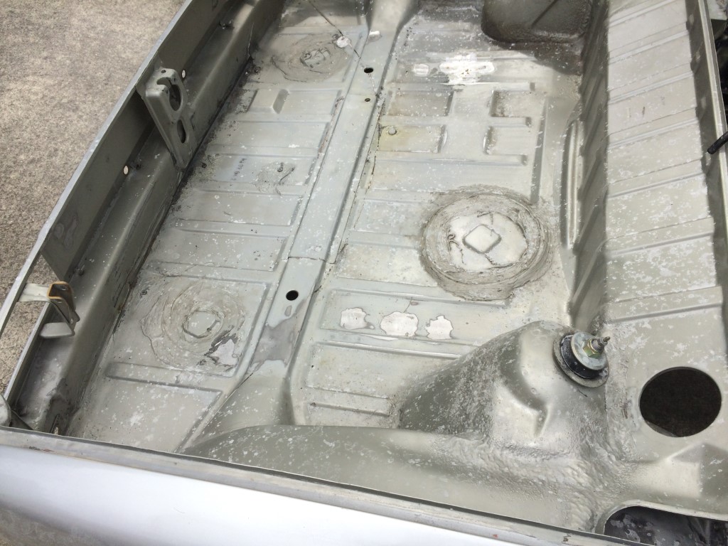

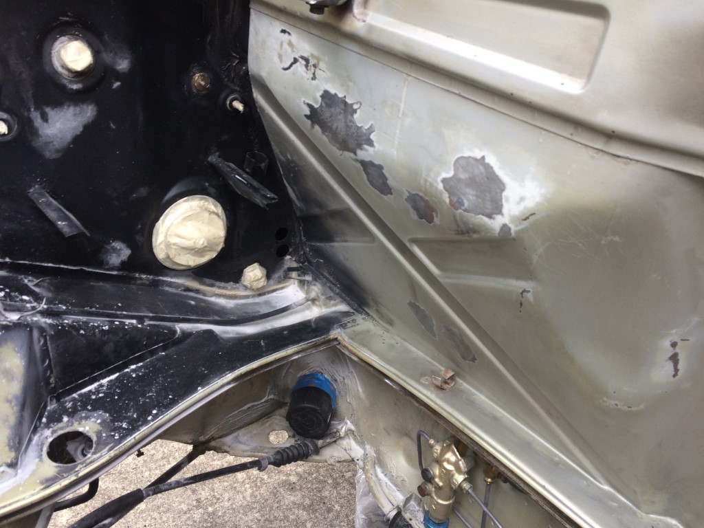

So I did what any 914 owner would do, tore into it further!
With the engine out and all of the wiring pulled from the engine compartment and trunk, I just blasted everything....and I mean everything. The tail light housings came out, the rear bumper and valance came off, the trunk lid and hinges, and the torsion rods for the engine lid and deck lid. Then I took the car over to a friend's shop to weld up some of the holes. All said and done, I think he welded up 26.
If you look on the left, you can see that I had already drilled out the broken ground stud, tapped some fresh threads, and installed a new ground stud.

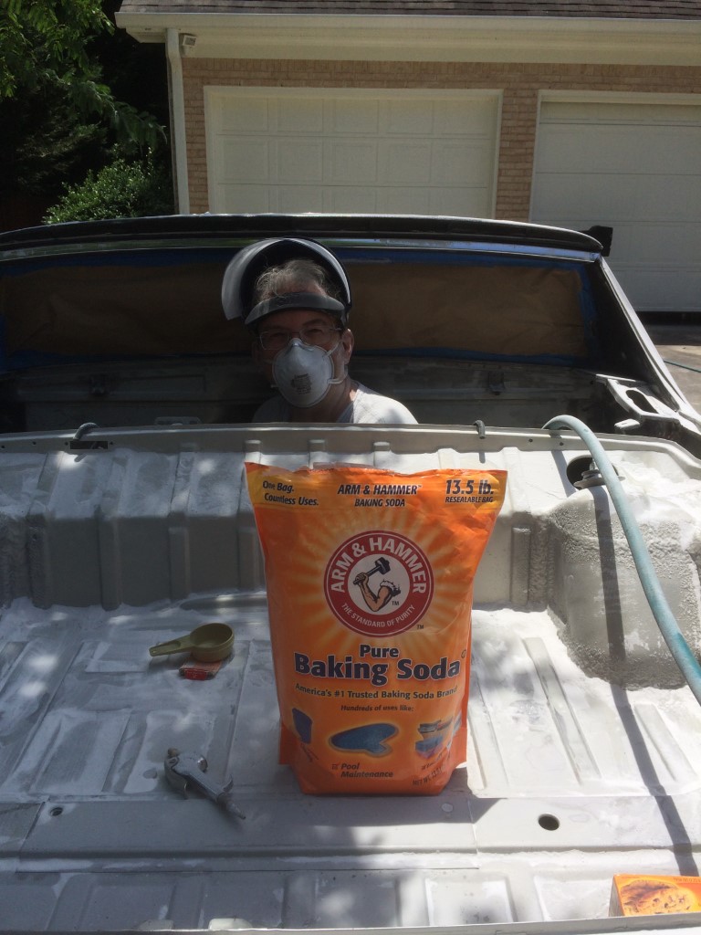

Then I bought a cheap soda blaster from Harbor Freight and got to work.
Attached ImageAttached ImageAttached Image
I was smiling in this pic but I'll tell you, I had spent a few gut-wrenching half-hours over the previous few weeks trying to decide that I really did want to "jump into the deep end of the pooling" doing all of this for the first time, in my driveway, over a couple of days, having never done this before and only having the guy at the paint shop to talk with about this. Luckily, it came out very good.

db9146   So I did what any 914 owner would do, tore into it...   Mar 10 2019, 06:54 PM
