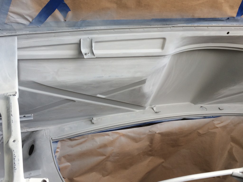

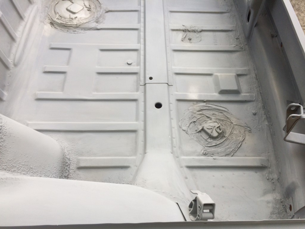

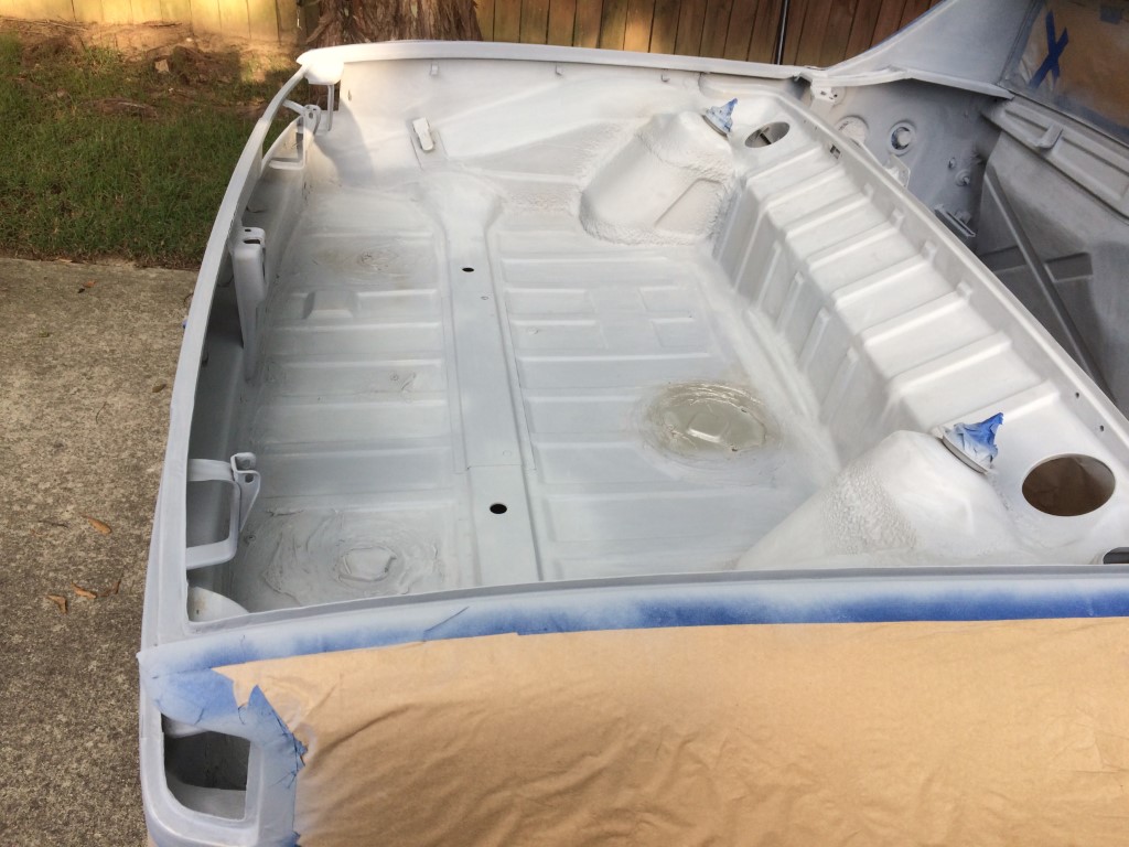

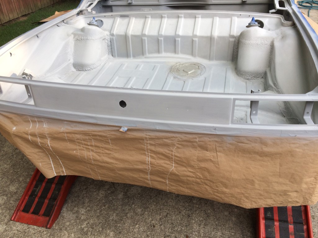

When I got done with the blasting (and I went through a lot of soda), I washed it all down good and then prepped the metal. Understand that I didn't blast all the way down to metal all over, I just blasted through the last repaint. If you look closely above, you'll see that the trunk was a little different color, more champagne in tint. Only where my friend had welded the holes was there any bare metal and after blasting and rinsing, it didn't take long for a little rust to appear. I knew that was likely so I used a little metal prep to neutralize the rust and then after wiping it all down with solvent and prep, I sprayed the engine compartment, trunk, and rear panel with some etching primer, sanded a little, building primer, then more sanding.
