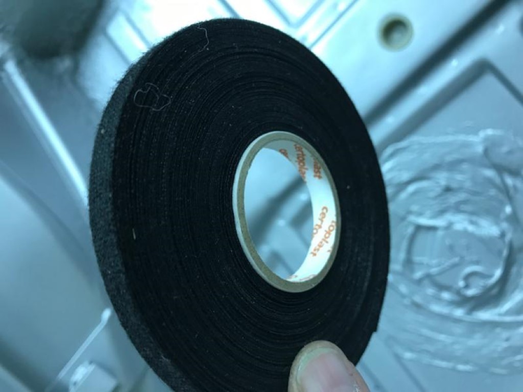

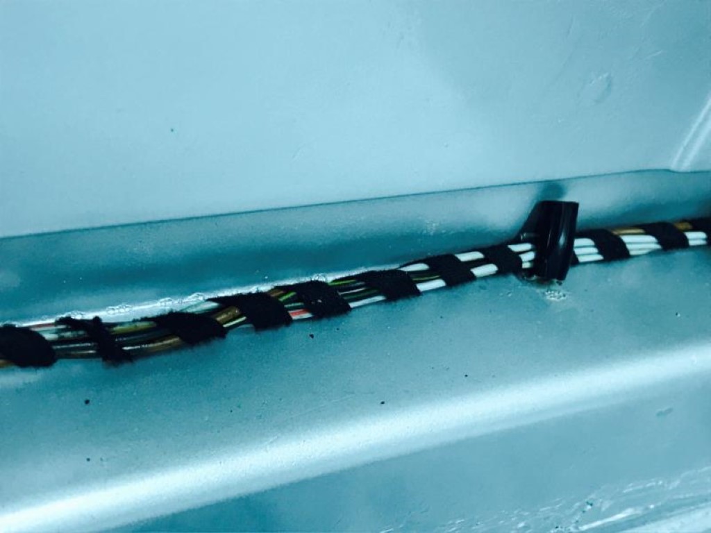

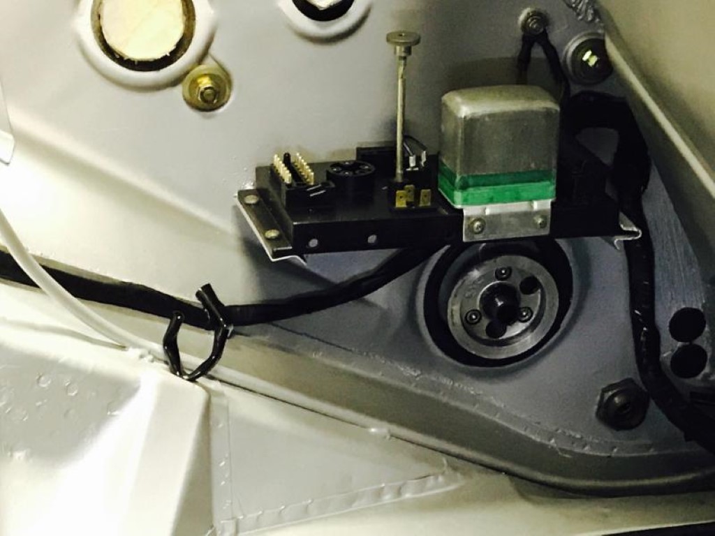

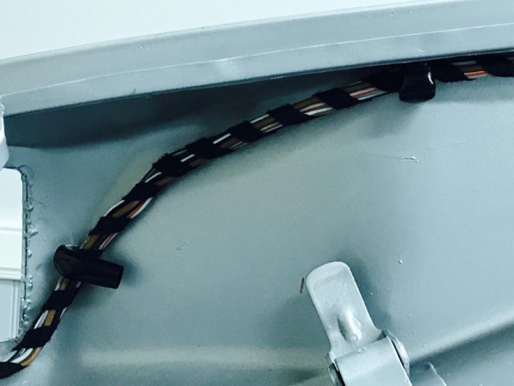

After finishing the prep, I sprayed the engine compartment and trunk with a single stage enamel. At some point, I'll paint the entire car but for this effort, it was just to get the areas cleaned up so I could install the new engine. I also resprayed the black on either side of the engine grill and the engine lid/grill as well.
Here's the fabric tape I got from 914Rubber.
And went from this:
to this after a lot of work and the new paint.....
