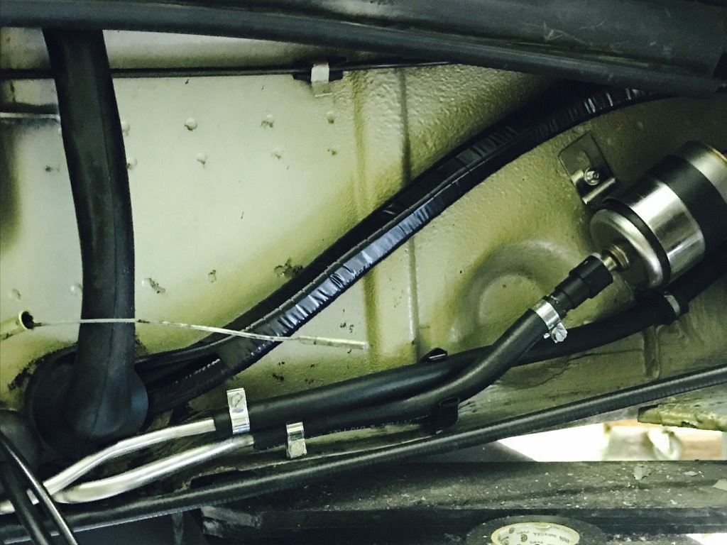

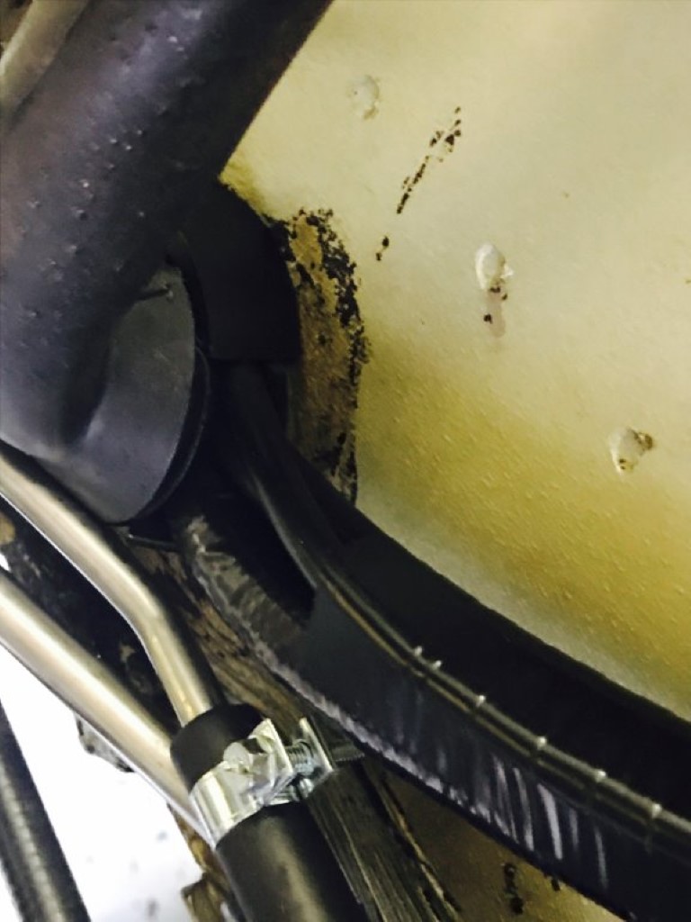

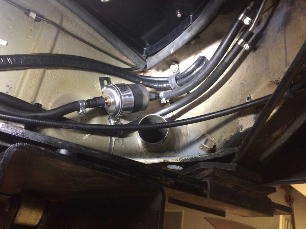

In preparation for installing the engine, I then started working on the fuel system and the chassis wiring.
For the fuel system, I purchased new stainless steel supply and return lines from Tangerine Racing and had then add the right flared ends on the lines for the high pressure connectors for the FI which will run at about 44PSI. I then started under the tank and added a small filter before the Walbro pump and then another 10 micron filter under the engine shelf.
For the ECU wiring (the ECU is mounted under the dash), there is the harness itself and a vacuum line for reading manifold pressure. I routed the harness and vacuum line down the center console and brought it out where the snorkel exits the firewall and routed them up through a factory opening in the engine shelf under the battery tray.
Since I couldn't route the ECU harness and vacuum line through the snorkel and I didn't want to damage the stock snorkel, I took a piece of 1 1/2 PVC, cut about a 1/2 long piece (just enough length to let the ECU wiring harness out from under the snorkel", and then cut a small section of the PVC to create a "C" shape. I slipped it over the harness and behind the snorkel to space it out from the firewall, and sealed it all with clear silicone. So its now watertight but also easily reverse-able.
