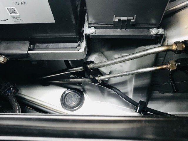

After I got the engine compartment and trunk painted, I worked to finish up all of the other items that I needed to do before the engine went back in. I ordered new stainless steel fuel lines from Tangerine Racing and installed those including the lines up through the side engine shelf with new grommets. I also replaced the rubber fuel lines with new FI rated ethanol-compatible line and FI clamps. I was also careful to support the lines with line clamps and a standoff to support the lines above the engine shelf in the engine compartment.
