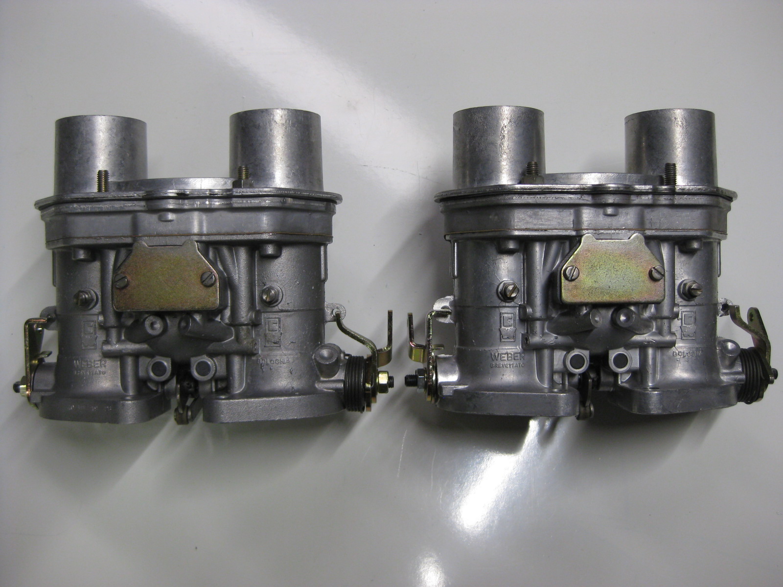

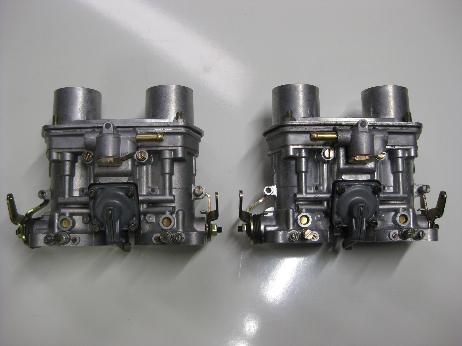

Here's a set of vintage 40 IDF model 18/19 that I just rebuilt
can't seem to find the before pic...but they were in very crappy condition
These have new shafts and sealed bearing in them so takes a little longer to rebuild.
The model 18/19 were made specifically for upgrades to the VW 1600-2000 engines T-1 to T4. They have the factory velocity stack / air horns (like Fiat 124 Abarth Spider)
and as you can also see they have the cold start circuit blocked off and not opened up on the inside.
Yours have the cold start...so be careful when taking apart as there are little springs under the two cone shaped things sticking up on the side with the cold start. Also a split brass washer holding it down...it will shoot across the garage and the parts are impossible to find.
Take your time and good luck on the rebuild.
