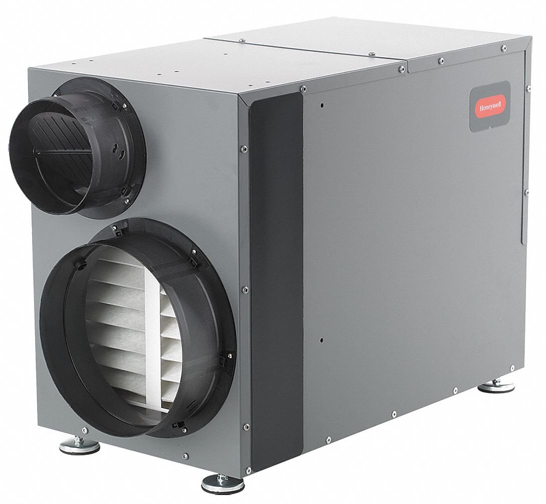

Consider buying a whole house dehumidifier. They integrate with your furnace and will out perform any wheel barrel style dehumidifier. The initial cost is salty, but you can save by doing the install yourself, also happy to walk you thru the control wiring.
Also consider buying a UV lamp for your HVAC equipment, its a effective way to kill any mold spores that may be already floating around.
