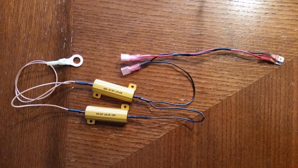

Matty900   The issue is the led is not pulling enough load. ...   Mar 29 2019, 11:19 PM
Spoke   ...it's a resistor and will get warm. Spoke,...   Mar 30 2019, 07:46 AM

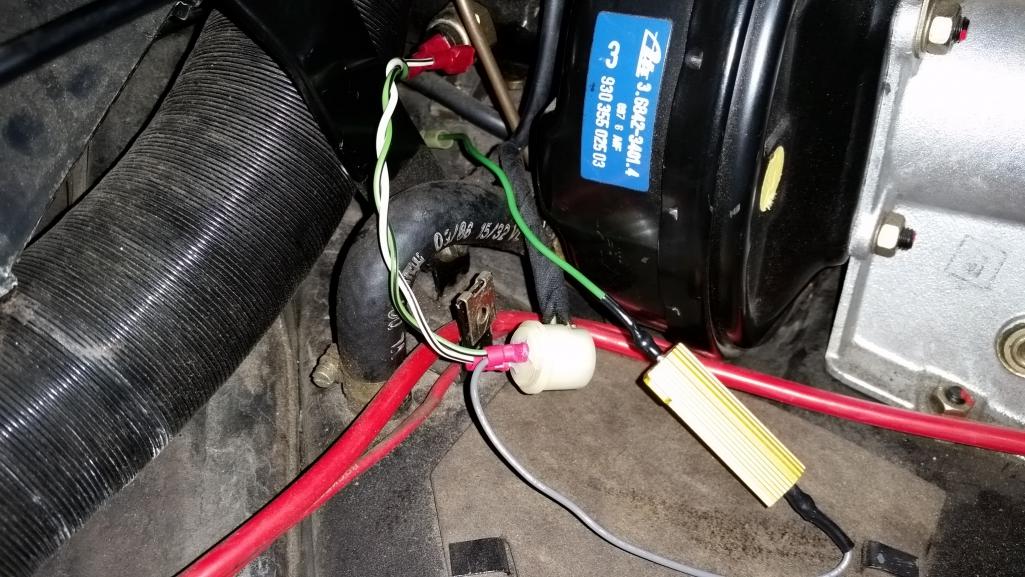

Spoke   Talking to Bruce today, I realized my 930 with LE...   Apr 6 2019, 10:34 AM
