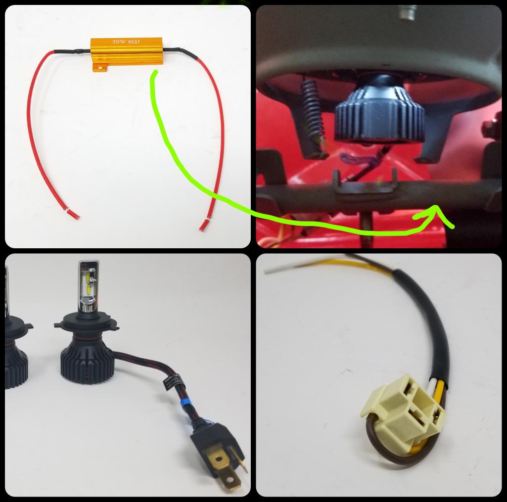

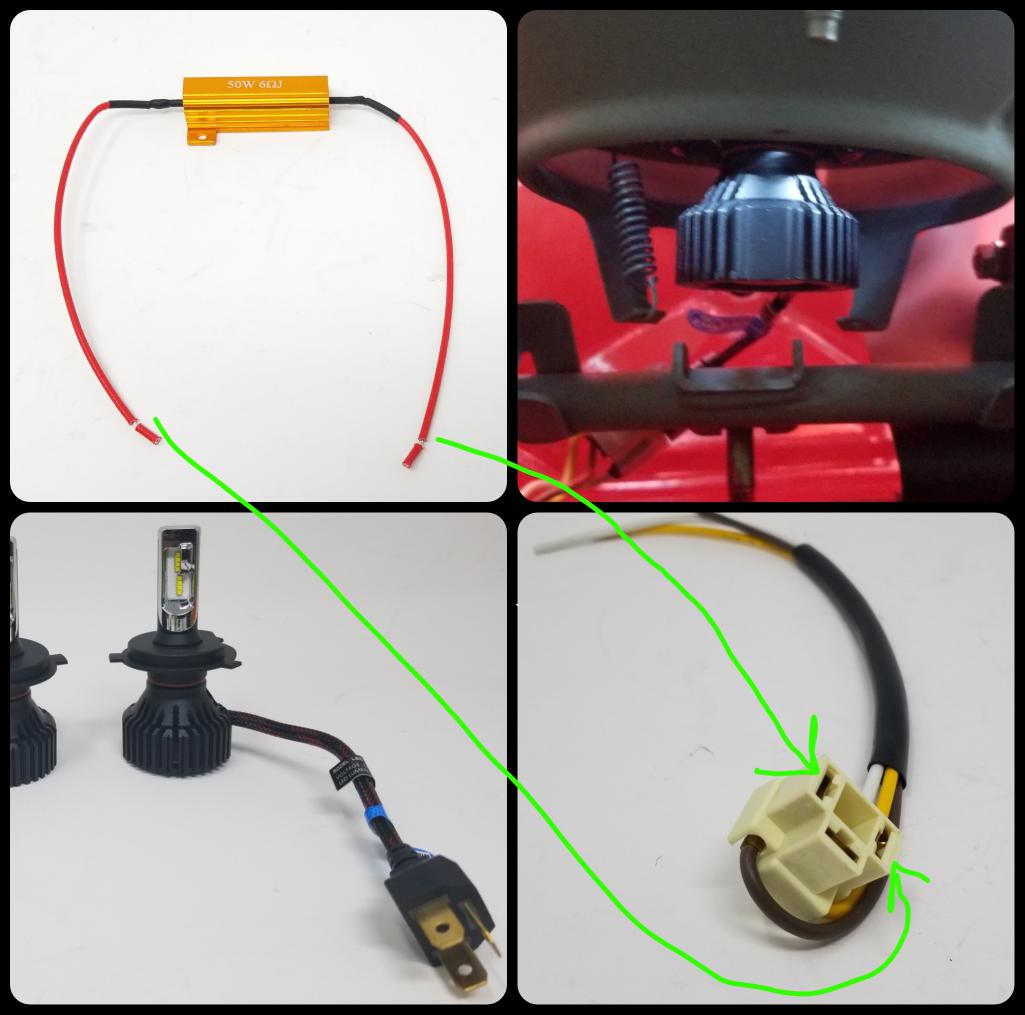

The issue is the led is not pulling enough load. When you add a resistor it solves the problem. We have them and I tested them to confirm that it solves the problem. I have not had the chance to finalize the install instructions and Bruce has been trying to help me on this. The only questions I have are where is the best place to mount it. One thought is to mount it to the headlight housing on the opposite side of the bar as far away from the metals pop up cover. The reason being, it's a resistor and will get warm. I don't want it next to the paint. The pros of putting it hear is that it is out of sight. The con's if you drive in the rain this can become a wet area so your connections need to be properly weather proofed (good barrel connectors and heat shrink.)
The 2nd photo is only showing you what wires you need to tie in to, not where to do so. However, you can put the wires in here and plug the light in to test and make sure this resolves your issue.
Spoke, Chi-town, Mike B where would you suggest mounting this?
