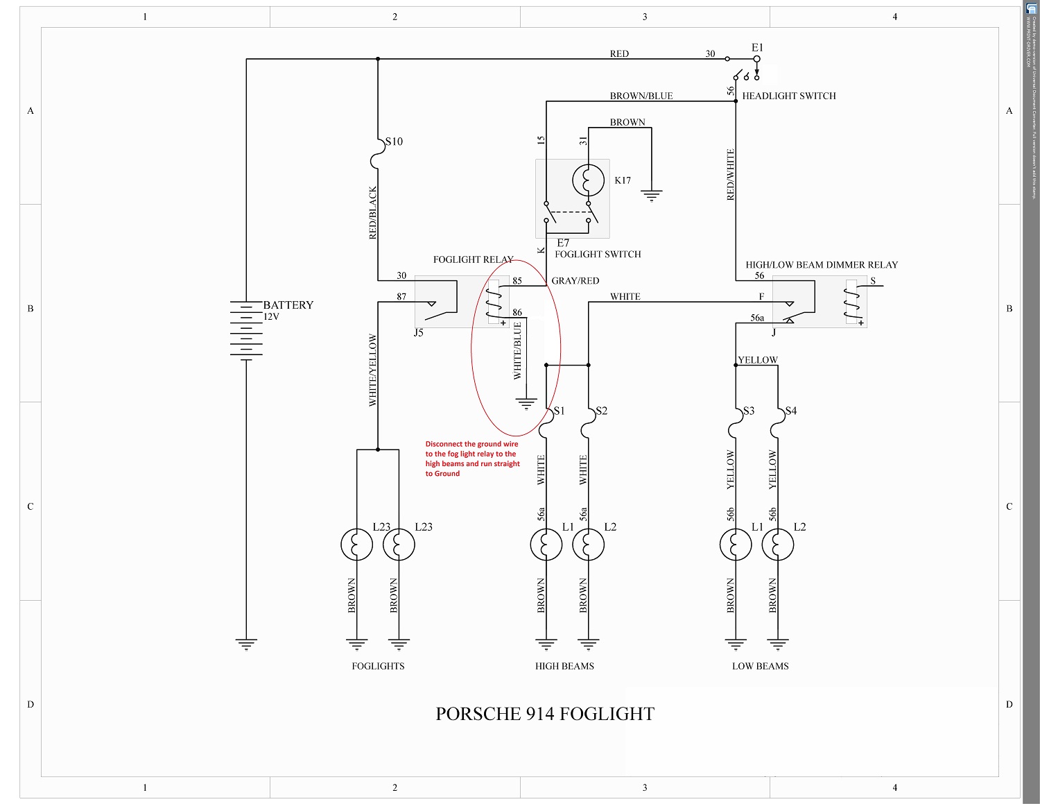

I love my brand new GE Nighthawks. There is no way I could go back to regular headlights. I had a set of sealed beam Hellas.
Last night I turned on the fog lights for the first time and the high beams came on. When I looked at the front of the car, all three were on: the regular lights, high beams AND the fog lights.
Any fix for this? I would like to have the fog lights and the low beams on at the same time without the high beams.
Edit: up until I installed the LED headlights, turning on the fog lights did NOT turn on the high beams. And turning on the high beams turned OFF the fog lights. In other words, normal behavior.
Thanks,
Paul

Easiest way

QUOTE(Chi-town @ Apr 1 2019, 04:11 PM) *
Easiest way
It could be so that this wire is found on the lugs on the fuse panel for fuse 1 or 2. Easily removed and with a pigtail with male spade on one side and ring terminal on the other side, the modification "should" be an easy update. The fogs would be on then with low or high beam.
Talking to Bruce today, I realized my 930 with LED headlights has the same connections as the 914. I haven't tried the foglights with the LED headlights to see if they still work. Will have to try it this weekend.

orthobiz   I never posted my final solution. I had the fogs w...   Apr 6 2019, 11:00 AM

Spoke   I modified the headlight/foglight schematic to sho...   Apr 7 2019, 09:48 PM
Spoke   I decided to rewire the foglight to be independent...   Apr 7 2019, 09:52 PM
Spoke   The white/blue wire to the foglight relay is cut a...   Apr 7 2019, 09:55 PM
Spoke   The other end of the new wire is grounded on this ...   Apr 7 2019, 09:57 PM
Mikey914   This would actually be the preferred method of ins...   Apr 7 2019, 10:18 PM
