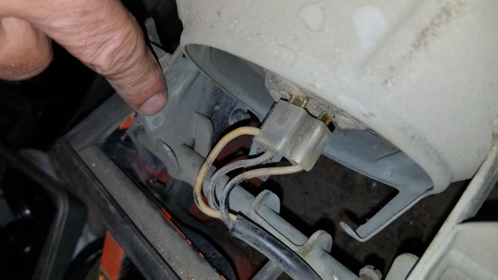

QUOTE(Spoke @ Apr 2 2019, 10:20 AM) *
I may drop the fuse panel this weekend in my 914 to look for the white/blue foglight wire.
@spoke
@chi-town
Dylan is going to try the same on a 914.
I like the option of separating the operation of the dogs from the headlights.
Still looking at best mounting for the load resitor.
Here is where I think it should go. Thick metal and air flow when the lights are up.
