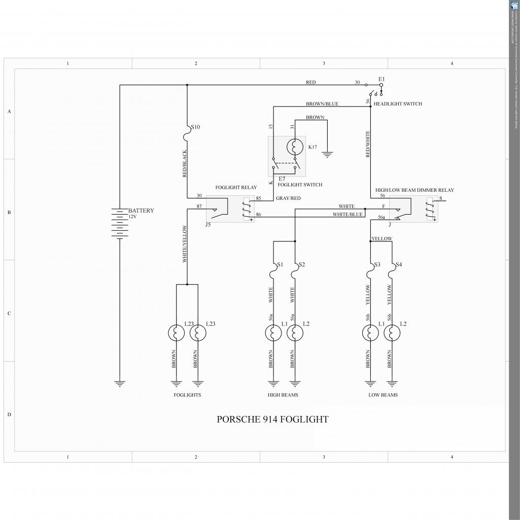

post Apr 7 2019, 09:48 PM
Jerry
Posts: 7,437
Joined: 29-October 04
From: Allentown, PA
Member No.: 3,031
I modified the headlight/foglight schematic to show where the foglight relay attaches to the high beam lights. Turns out the 914 is wired such that the white/blue wire from the foglight relay is connected directly to the spade connected to the high/low beam relay.

Spoke   I modified the headlight/foglight schematic to sho...   Apr 7 2019, 09:48 PM
Spoke   I decided to rewire the foglight to be independent...   Apr 7 2019, 09:52 PM
Spoke   The white/blue wire to the foglight relay is cut a...   Apr 7 2019, 09:55 PM
Spoke   The other end of the new wire is grounded on this ...   Apr 7 2019, 09:57 PM
