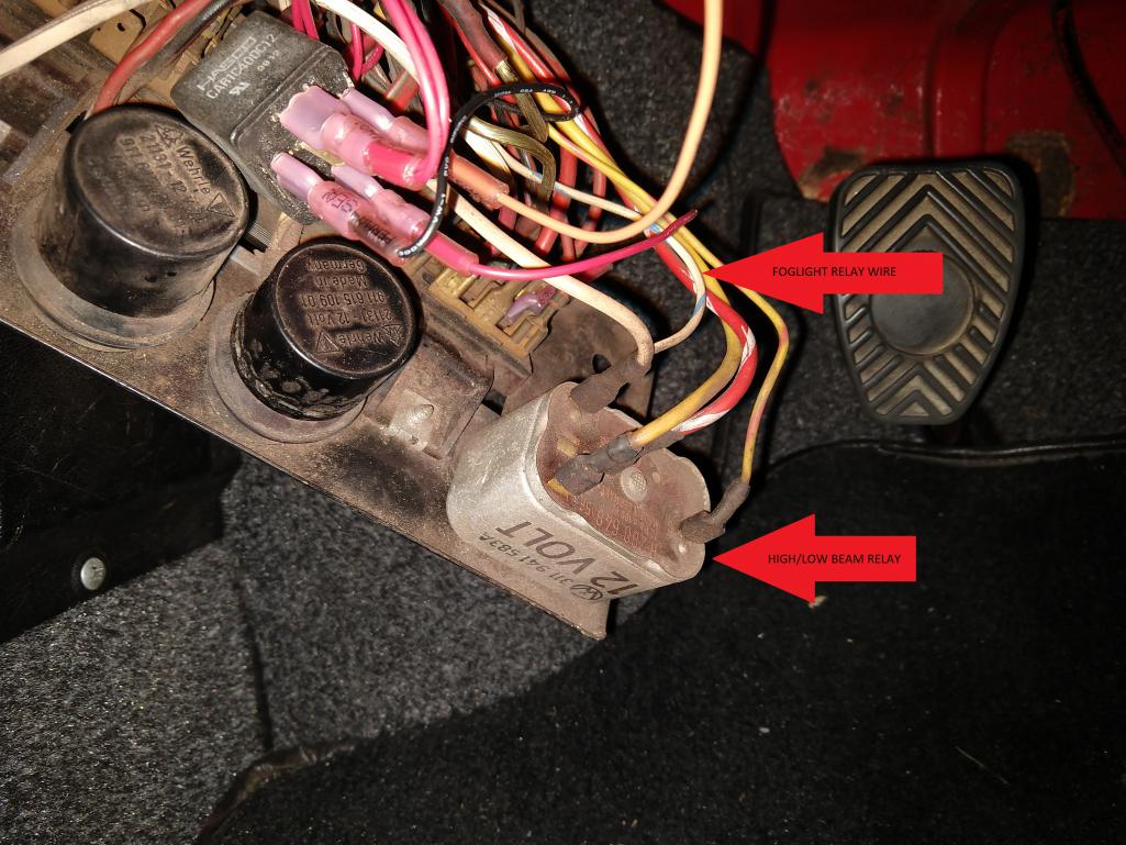

I decided to rewire the foglight to be independent of the high beams. Disconnected the battery negative cable and dropped the fuse panel.
The high/low beam relay is shown on the right side of the panel. The foglight wire is the white/blue wire. This wire will be cut and tied to ground.

Spoke   I decided to rewire the foglight to be independent...   Apr 7 2019, 09:52 PM
Spoke   The white/blue wire to the foglight relay is cut a...   Apr 7 2019, 09:55 PM
Spoke   The other end of the new wire is grounded on this ...   Apr 7 2019, 09:57 PM
