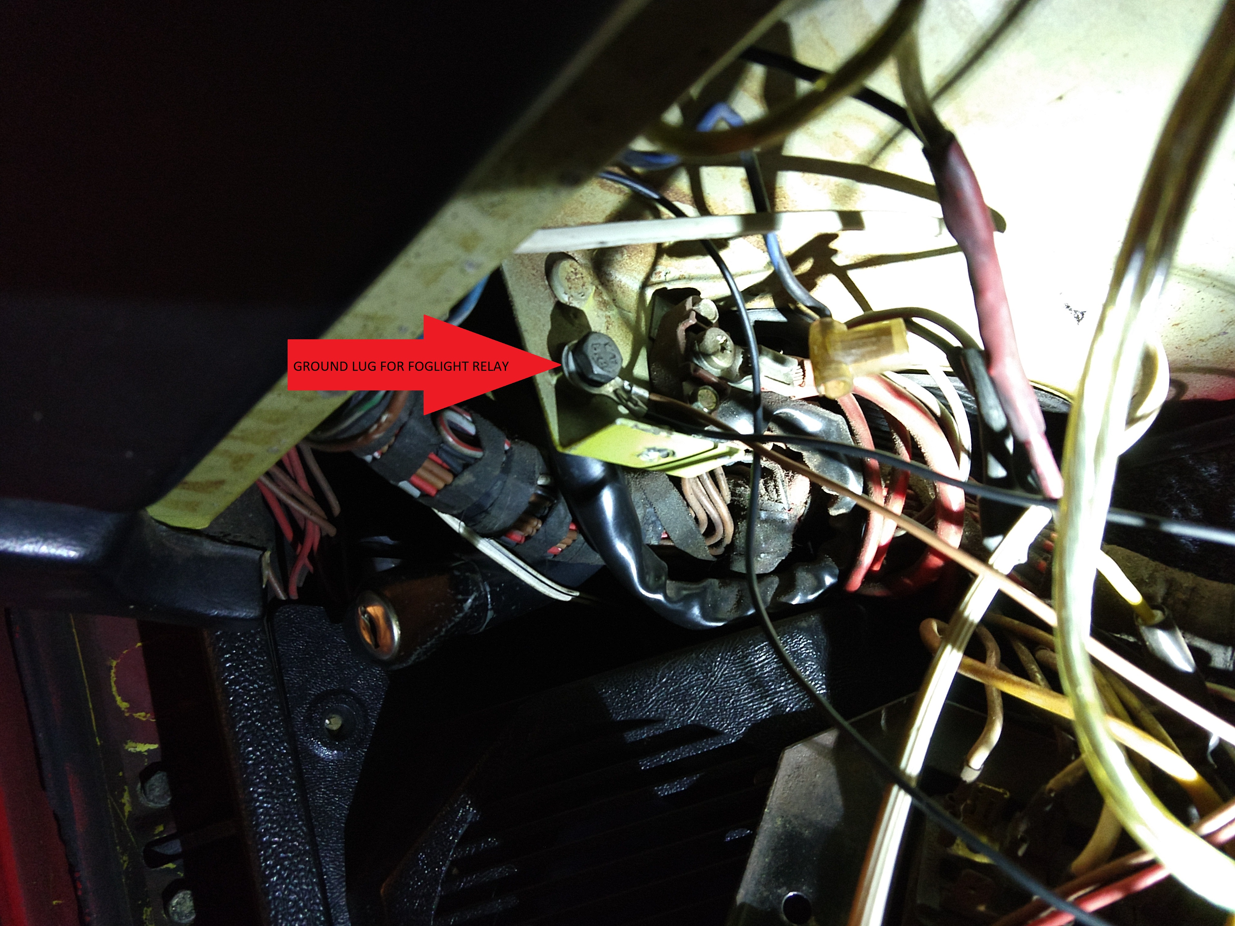

orthobiz   I never posted my final solution. I had the fogs w...   Apr 6 2019, 11:00 AM
FlacaProductions   separately? you mean direct and bypassing the int...   Apr 6 2019, 01:13 PM
orthobiz   separately? you mean direct and bypassing the in...   Apr 6 2019, 02:35 PM
Spoke   I modified the headlight/foglight schematic to sho...   Apr 7 2019, 09:48 PM
Spoke   I decided to rewire the foglight to be independent...   Apr 7 2019, 09:52 PM
Spoke   The white/blue wire to the foglight relay is cut a...   Apr 7 2019, 09:55 PM
Spoke   The other end of the new wire is grounded on this ...   Apr 7 2019, 09:57 PM
