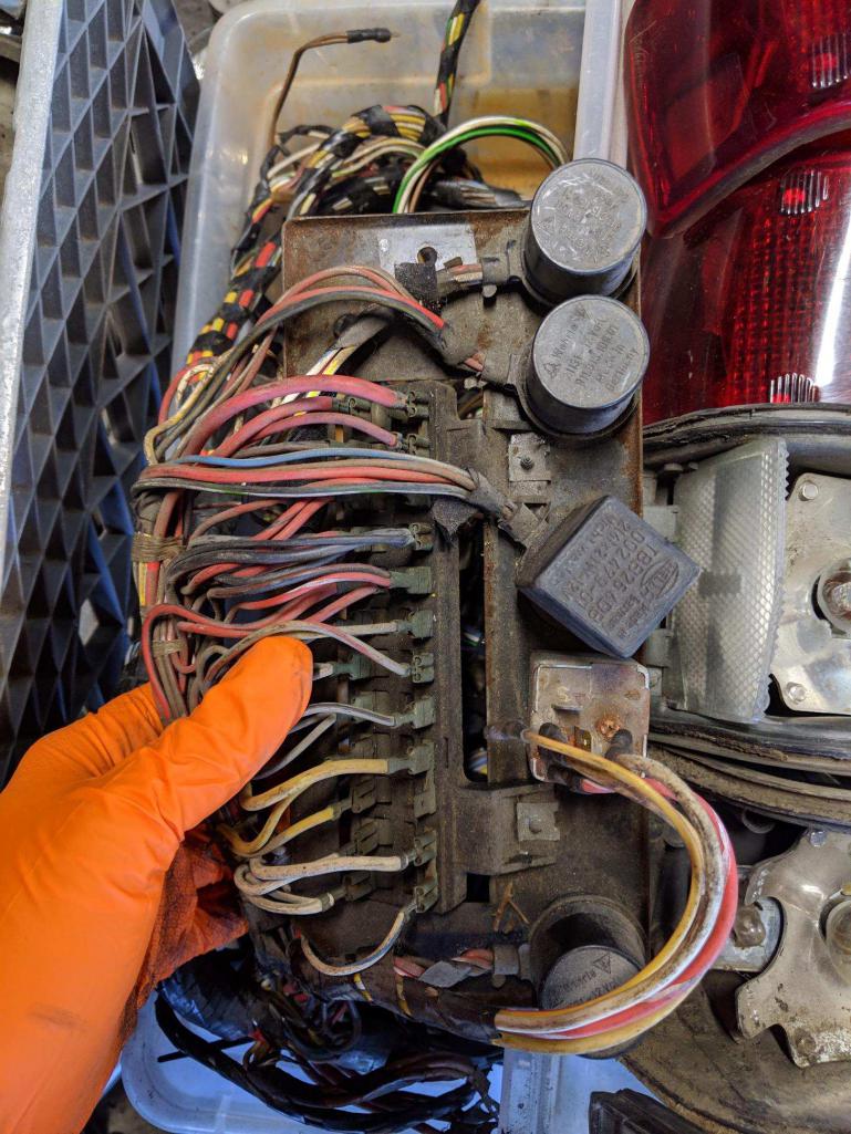

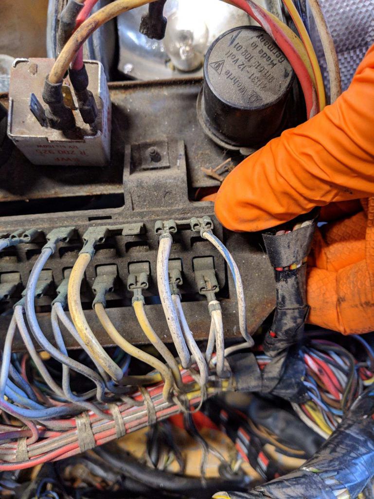

QUOTE(FlacaProductions @ Apr 10 2019, 07:50 PM) *
Should the line coming off the high/low beam relay just be capped off?
@FlacaProductions
No. The solution is to remove the blue/wite wire from the fuse panel and run directly to ground.
Pictures from @chi-town .
