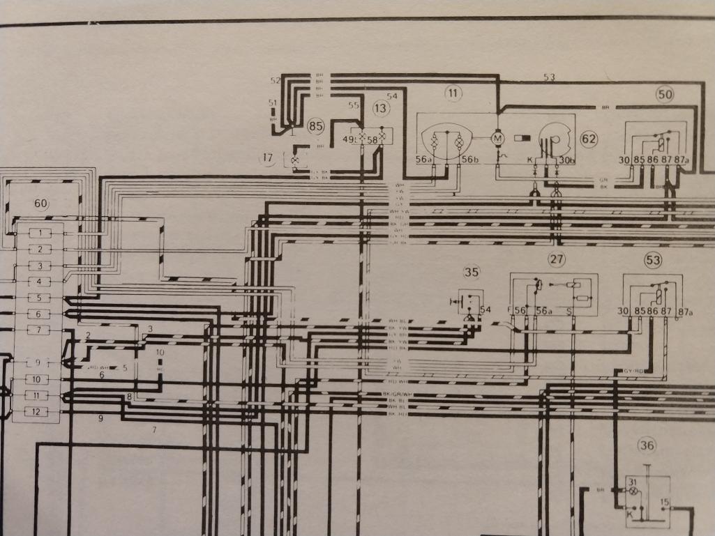

2) "1972, 1973, USA and except-USA" White/Blue wire connected to Fuse 1. Foglight relay is #53; Headlight switch is #27. Note wire on pin 85 on #53 foglight relay connecting to Fuse 1.

Spoke   I modified the headlight/foglight schematic to sho...   Apr 7 2019, 09:48 PM
Spoke   I decided to rewire the foglight to be independent...   Apr 7 2019, 09:52 PM
Spoke   The white/blue wire to the foglight relay is cut a...   Apr 7 2019, 09:55 PM
Spoke   The other end of the new wire is grounded on this ...   Apr 7 2019, 09:57 PM

Spoke   These images are from my Haynes 914 Owners Worksho...   Apr 12 2019, 07:18 AM
Biggles   Great info! I’ve got this issue too on my ...   Apr 12 2019, 11:58 AM
Spoke   Great info! I’ve got this issue too on my...   Apr 12 2019, 01:43 PM
Spoke   2) "1972, 1973, USA and except-USA" Whit...   Apr 12 2019, 07:22 AM
Spoke   3) "1974, 1975, USA and except-USA" Whit...   Apr 12 2019, 07:25 AM
