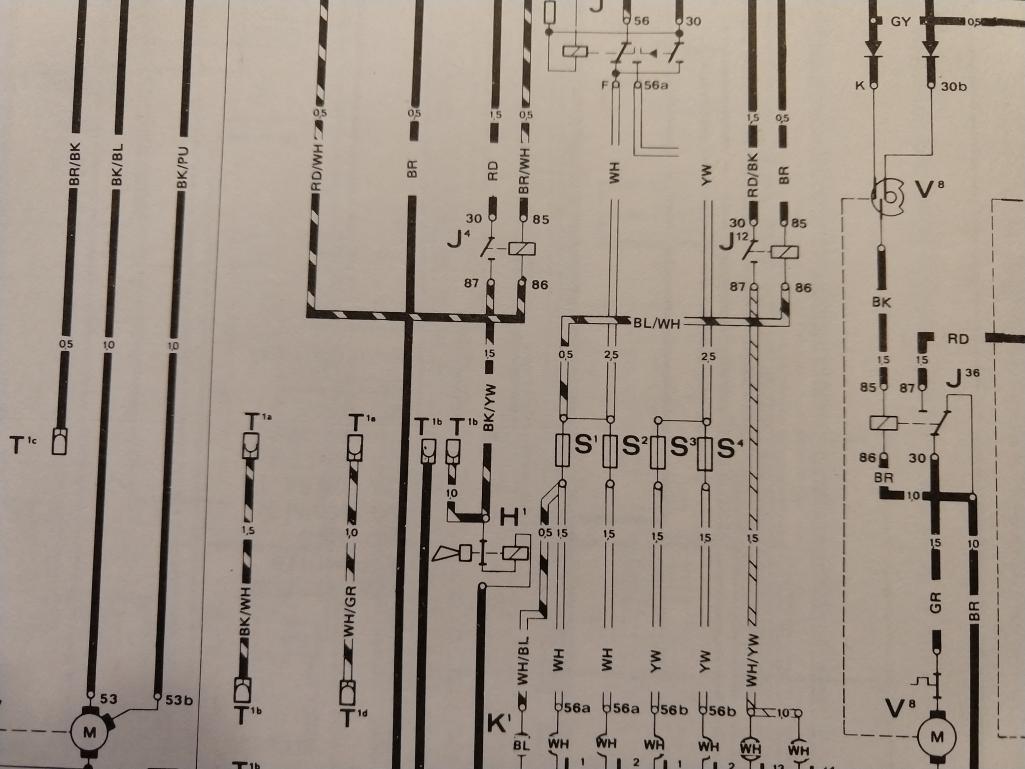

3) "1974, 1975, USA and except-USA" White/Blue wire connected to Fuse 1. Foglight relay is J12. Note wire on pin 86 on J12 foglight relay connecting to Fuse 1.
Also note that in previous years, it was pin 85 used as the switched ground for the foglight relay. Here it is pin 86. For those questioning whether a relay coil could be powered one way or another, looks like Porsche answered that question...
