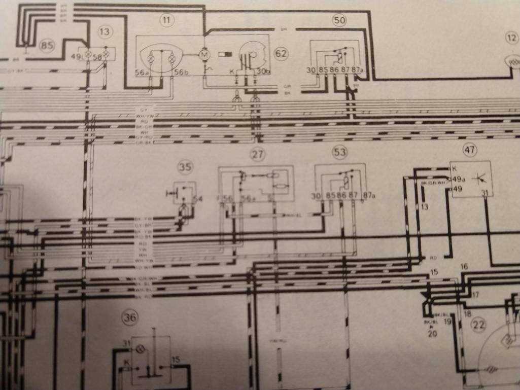

These images are from my Haynes 914 Owners Workshop Manual. It shows only the "Up to 1971, USA and except-USA" cars have the white/blue wire to the foglight connected directly to the wire spade connector on the high/low headlight relay. All other years show the white/blue wire connected to Fuse 1.
It shows basically 3 different drawings of 2 configurations:
1) "Up to 1971, USA and except-USA" White/Blue wire connected at High/Low Relay.
2) "1972, 1973, USA and except-USA" White/Blue wire connected to Fuse 1.
3) "1974, 1975, USA and except-USA" White/Blue wire connected to Fuse 1.
Here is "Up to 1971, USA and except-USA" White/Blue wire connected at High/Low Relay. Foglight relay is #53; Headlight switch is #27. Note wire on pin 85 on #53 foglight relay connecting directly to the spade on pin F on #27 high/low headlight relay.

Spoke   I modified the headlight/foglight schematic to sho...   Apr 7 2019, 09:48 PM
Spoke   I decided to rewire the foglight to be independent...   Apr 7 2019, 09:52 PM
Spoke   The white/blue wire to the foglight relay is cut a...   Apr 7 2019, 09:55 PM
Spoke   The other end of the new wire is grounded on this ...   Apr 7 2019, 09:57 PM

Spoke   These images are from my Haynes 914 Owners Worksho...   Apr 12 2019, 07:18 AM
Biggles   Great info! I’ve got this issue too on my ...   Apr 12 2019, 11:58 AM
Spoke   Great info! I’ve got this issue too on my...   Apr 12 2019, 01:43 PM
Spoke   2) "1972, 1973, USA and except-USA" Whit...   Apr 12 2019, 07:22 AM
Spoke   3) "1974, 1975, USA and except-USA" Whit...   Apr 12 2019, 07:25 AM
