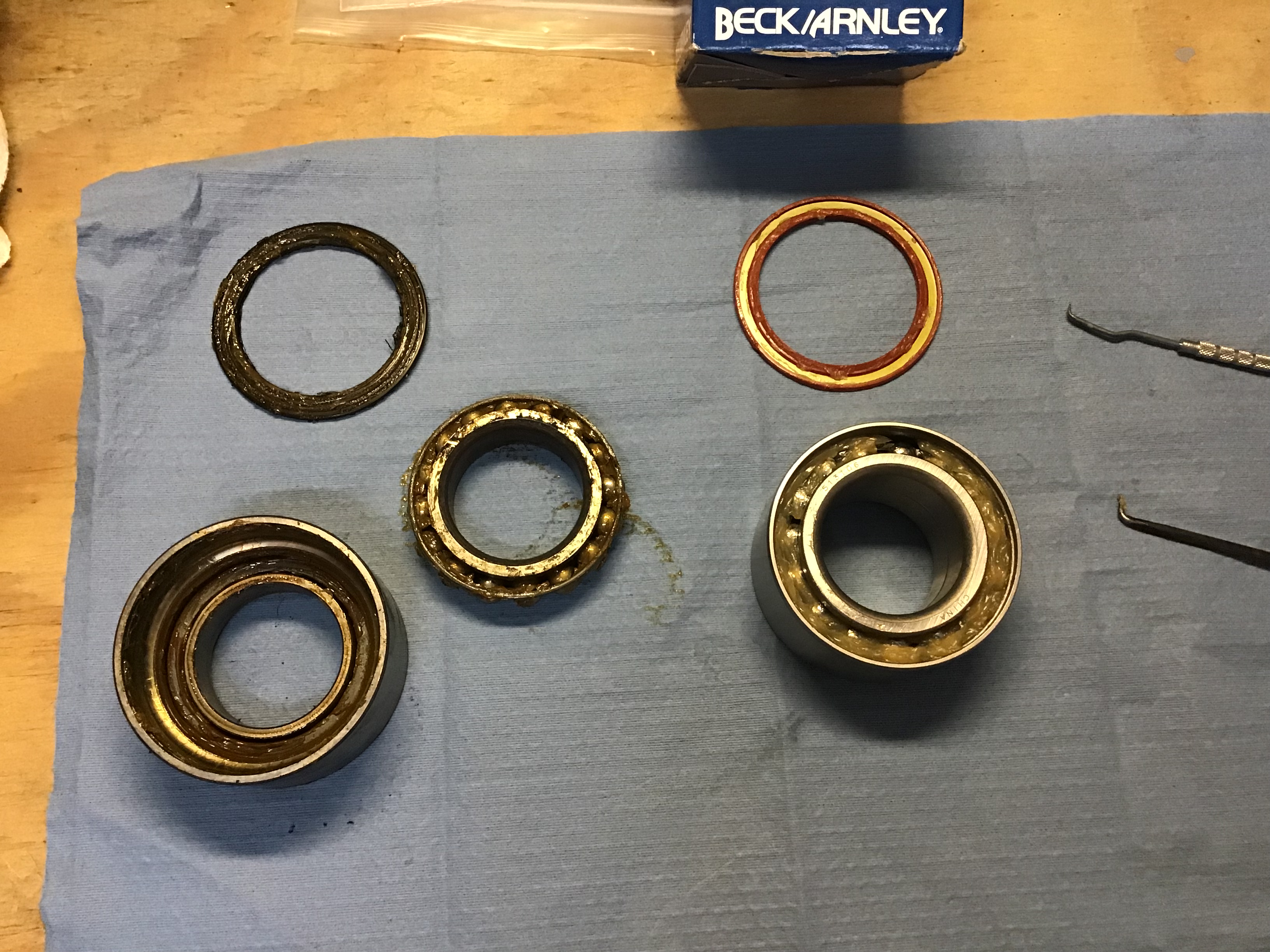

Out of curiosity I took apart my old one that appears to be original ( SKF) and then a new Beck Arnley bearing to compare. I found both to have, what I feel, is plenty of grease. Attached Image
