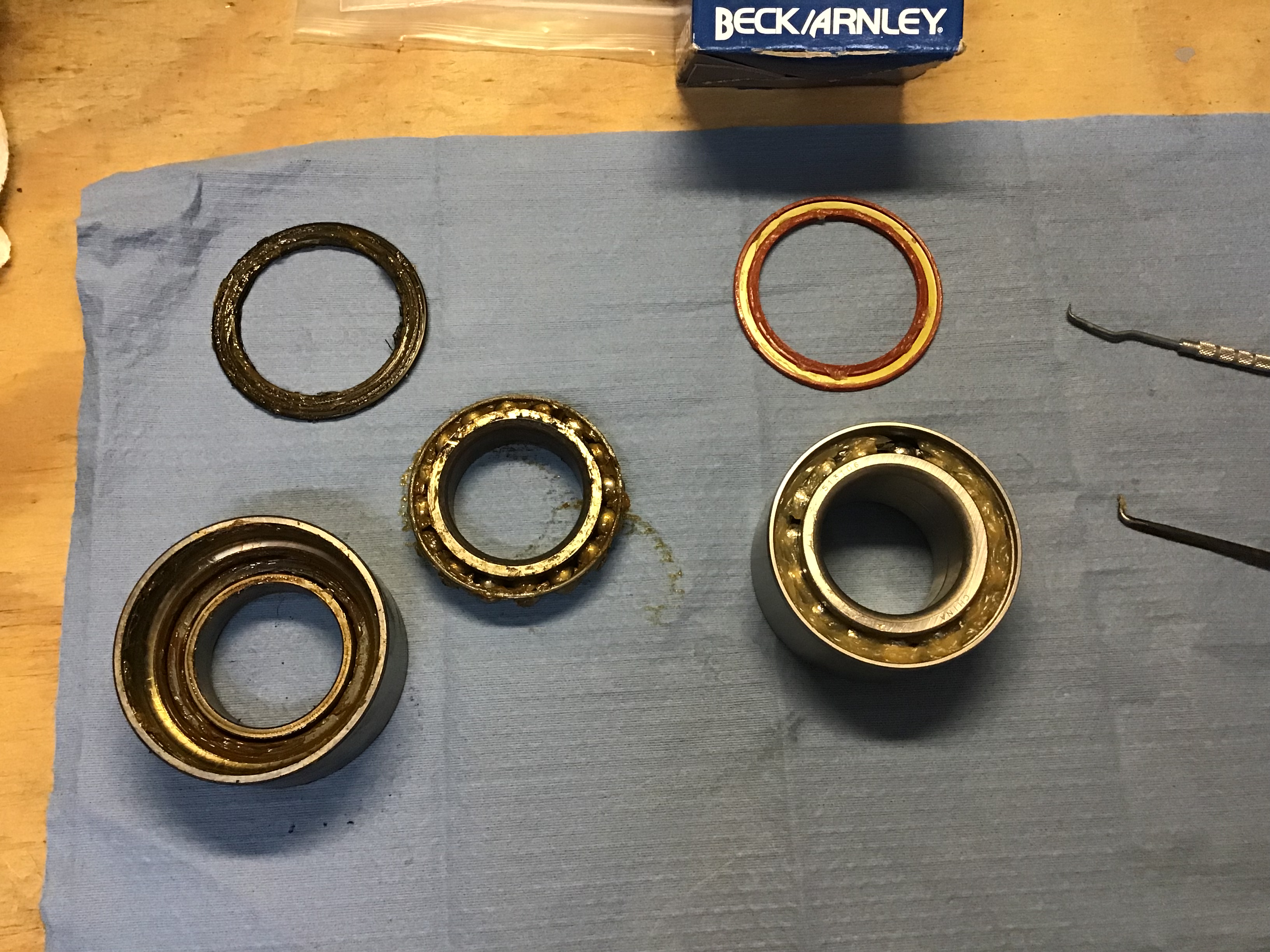

Luke M
I got around to repacking the bearings today.
I opened up the second bearing and found that it had a little more grease in it.
The grease looked better in this bearing also not as chunky but still didn't seam or feel right. I cleaned it all up and installed new grease. I feel better now knowing there's grease in the bearings. I would hate to do this all over if a bearing failed.
Check the pics and you decide if that's enough grease in there.
I can tell you this, one bearing was 90% dry on one side.

bbrock
QUOTE(Luke M @ Apr 11 2019, 05:30 PM) *
This is my totally NON-EXPERT opinion so take it for what it is worth, but that bearing looks pretty good to me. Even though part of it is dry, it looks like there is enough grease in the right places that it would be dragged around and coat everything in the first few revolutions of the assembled bearing. But what the heck do I know? It's way more grease than I found in my worst bearing anyway. confused24.gif

QUOTE(bbrock @ Apr 13 2019, 12:03 AM) *
Good info. Might be true about Honda techs but we can't blame them for my experience because the bearings they put in lasted at least as long as the ones the factory put in.
I wish you had been here when I opened my bearings. Would have been interesting to get your thoughts seeing them first hand.
We have a 2009 & 2017 crv. No issues yet. Odyssey went 275k without touching bearing or really anything else before it was rear ended for the third time and totaled.
Superhawk996
@bbrock
Brent, I just want to be completely transparent that I'm not targeting you personally. I have no doubt that that one of your bearings had less lube than the others. Nor do I mean to question your mechanical ability or personal integrity. Your build is by far one of the most inspirational on this site and your attention to detail is an example for all of us to shoot for. grouphug.gif
There is a saying:
Arguing with an engineer is like wresting a pig in mud, eventually you'll realize the pig likes it.
My broader point in keeping this post going is that we all have limited time to focus on our projects. What we do with them is our own prerogative and we should all do what keeps us happy. My intent to the original post was to offer a perspective to the OP that bearings are in general pretty robust little pieces of hardware and that I personally wouldn't sweat them. Worst case is that one fails prematurely and we have to replace it. Things could be worse things in life.
As engineers we seek to design parts to a particular life cycle. Particularly the b10 life which is defined as:
"The measurement of the time by which ten percent of a population of a product will have failed. The term originates from the manufacture of anti-friction bearings, and is used to express the minimum lifetime of ninety percent of a given batch of bearings operating within speed and loading tolerances."
Whatever that life cycle is designed to be, the parts then have to be manufactured, and within that process, we shoot for six sigma capability which is defined as a bell curve, normal distribution where we want 99.7% of the manufactured product to meet the b10 life as produced. Getting rid of that 0.3% drives up costs exponentially.
The bottom line is that there will be some very low number of parts that don't meet the b10 life due to the process variation during manufacture. You very well may have had one of the 0.3% of parts that might fall below b10 life. Who knows for sure? I sure don't.
My broader point in all this was that ball bearings don't even need lubrication (IN THEORY). Lubrication just makes them last much longer and that the lubrication method is variable. Grease isn't even an ideal lubricant . . . ideally you would want just a light mist of oil continuously applied, especially at high shaft speeds. Grease generates too much heat and too much friction at high shaft speeds (talking 10,000+ rpm type speed here - not car axles). A nice oil mist is hard to achieve in practice in precision machinery and is impossible to have in a wheel bearing and would be incredibly maintenance intensive. Therefore grease is a pretty good compromise that lasts a long time and doesn't require much maintenance.
Going out to do some real work on the beast!
I used to use light oil on the bearings of my track bike when I raced on the velodrome. Cup and cone campagnolo bearings. Spun forever.
bbrock
QUOTE(mepstein @ Apr 13 2019, 05:40 AM) *
I think our 2006 was the last year for that chassis before they rolled out a completely redesigned model. The bearings were changed to what looks like the Gen2 or Gen3 @Superhawk996 described. I don't think my brother had any issues with his Odyssey either. Don't get me wrong. We love our CRV. Other than the rear bearings, over 260K of trouble free miles and it still drives like new.
bbrock
QUOTE(Superhawk996 @ Apr 13 2019, 07:15 AM) *
There is a saying:
No worries. I'm an ecologist which is just a fancy term for another pig who likes to wrestle. I'm not sure we'll get to the bottom of best practices for these FAG bearings though. beerchug.gif
