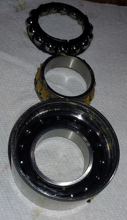

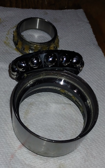

So, I just purchased a set of New FAG wheel bearing (made in Germany) so I can install a set of the later (74-89) 911 rear hubs on my 914 control arms.
I saw a few you tube videos about how the bearings for the Boxster where being shipped with little to no grease in them. I figured before I install them to check the grease. Well sure enough one side had little grease and the other side had very little to no grease on the bearings. I should've taken a few pics but didn't have my phone handy. I still have another new bearing to inspect so I'll take pics of that one. I'm sure it will be the same way. Now to go pick up some grease and repack them.
So if anyone of you out there plan on replacing your rear bearing I would inspect them.

Hi Mark,
Yes, the ones I just got from you. I'm guessing it's been an issue for awhile now. I'll pull the other bearing apart tmrw and post pics.
I just removed my old but new never run bearings.
I'll pull those apart too to see if there's grease in them.

The other thing that I noticed with the grease is that it was chunky. The grease may have just deteriorated with age? These are new but old stock bearings.
I looked at Brent's post. His bearings had by far more grease in them then these.
It could be that with age (now 20 plus years) that the grease just broke down.
I will tear into the other bearing today and post pics of the findings.

You have to scroll down to the second one I opened to see the bad one. The first one I opened had what looked like an adequate amount of grease. It was unevenly distributed, but both bearing races had enough grease to be lubricated while the grease redistributed itself from use.
The second bearing I opened (same manufacturer purchased at the same time) was a different story. One side of the bearing was completely bone dry without even a hint of grease. The other side had such a small amount that there is no way it would have been enough to lubricate both sides, and even if it was, one side of the bearing would have run dry for some time before the grease redistributed. I'd say that bearing had maybe 1/5th the amount total as the first bearing.
From what I saw, there is absolutely a quality control problem with these bearings and I wouldn't trust that the manufacturer is greasing them properly. There shouldn't be huge differences in the quantity of grease from bearing to bearing.

All I can speak for is what I saw. I opened what should have been two identical bearings and found significant differences in the amount of grease inside. I agree about not trusting what you find on the Interwebs, but what I found with only two bearings fit perfectly with what the "Interweb experts" were saying.
In the video you posted, you'll notice the guy who opens the bearing says that one actually looks pretty good but has more grease than other ones he opened which indicates he's seen the same variability I found in only opening two.. My first bearing I opened had about this same amount of grease and i also thought it looked okay. But the second one, no way.
The vid in the original post is a good tutorial on opening the bearings, but I would say the bearing he opened had adequate grease. It seems to me the area he points out with "no grease" would have been lubricated after the first few rotations of the bearing. On one that I opened, one whole side (bearing cage and race) was completely dry and I think there is a good chance you could be driving at speed for some time before any of the stingy amount of grease on the other side found its way over.
Obviously my observation isn't definitive and I'm no expert, but from what I, and others have seen, I think at least a quick inspection before installing these bearings is time well spent.

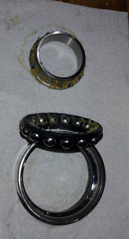

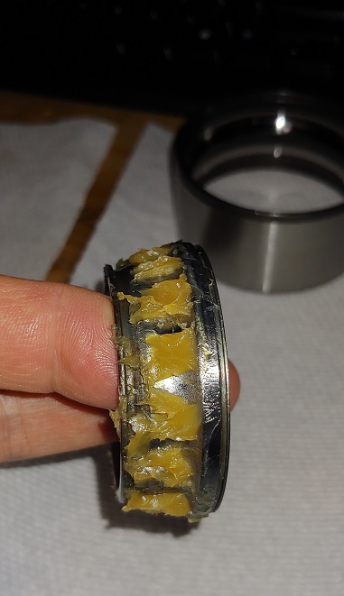

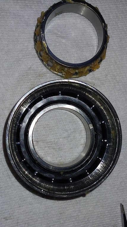

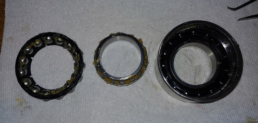

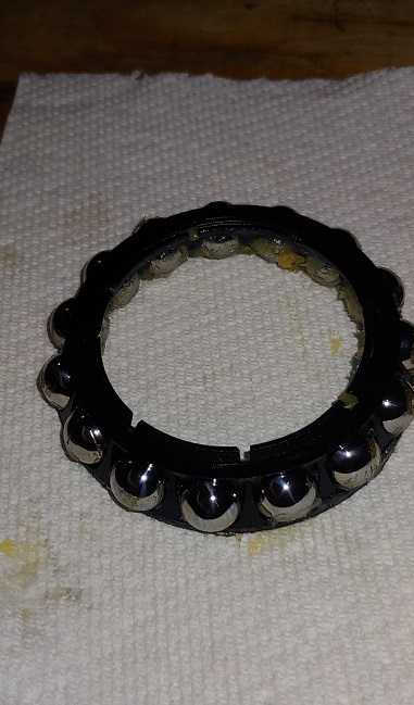

I got around to repacking the bearings today.
I opened up the second bearing and found that it had a little more grease in it.
The grease looked better in this bearing also not as chunky but still didn't seam or feel right. I cleaned it all up and installed new grease. I feel better now knowing there's grease in the bearings. I would hate to do this all over if a bearing failed.
Check the pics and you decide if that's enough grease in there.
I can tell you this, one bearing was 90% dry on one side.
Attached Image Attached Image Attached Image Attached Image Attached Image Attached Image Attached Image Attached Image
