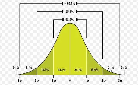

As engineers we seek to design parts to a particular life cycle. Particularly the b10 life which is defined as:
"The measurement of the time by which ten percent of a population of a product will have failed. The term originates from the manufacture of anti-friction bearings, and is used to express the minimum lifetime of ninety percent of a given batch of bearings operating within speed and loading tolerances."
Whatever that life cycle is designed to be, the parts then have to be manufactured, and within that process, we shoot for six sigma capability which is defined as a bell curve, normal distribution where we want 99.7% of the manufactured product to meet the b10 life as produced. Getting rid of that 0.3% drives up costs exponentially.
The bottom line is that there will be some very low number of parts that don't meet the b10 life due to the process variation during manufacture. You very well may have had one of the 0.3% of parts that might fall below b10 life. Who knows for sure? I sure don't.
My broader point in all this was that ball bearings don't even need lubrication (IN THEORY). Lubrication just makes them last much longer and that the lubrication method is variable. Grease isn't even an ideal lubricant . . . ideally you would want just a light mist of oil continuously applied, especially at high shaft speeds. Grease generates too much heat and too much friction at high shaft speeds (talking 10,000+ rpm type speed here - not car axles). A nice oil mist is hard to achieve in practice in precision machinery and is impossible to have in a wheel bearing and would be incredibly maintenance intensive. Therefore grease is a pretty good compromise that lasts a long time and doesn't require much maintenance.
