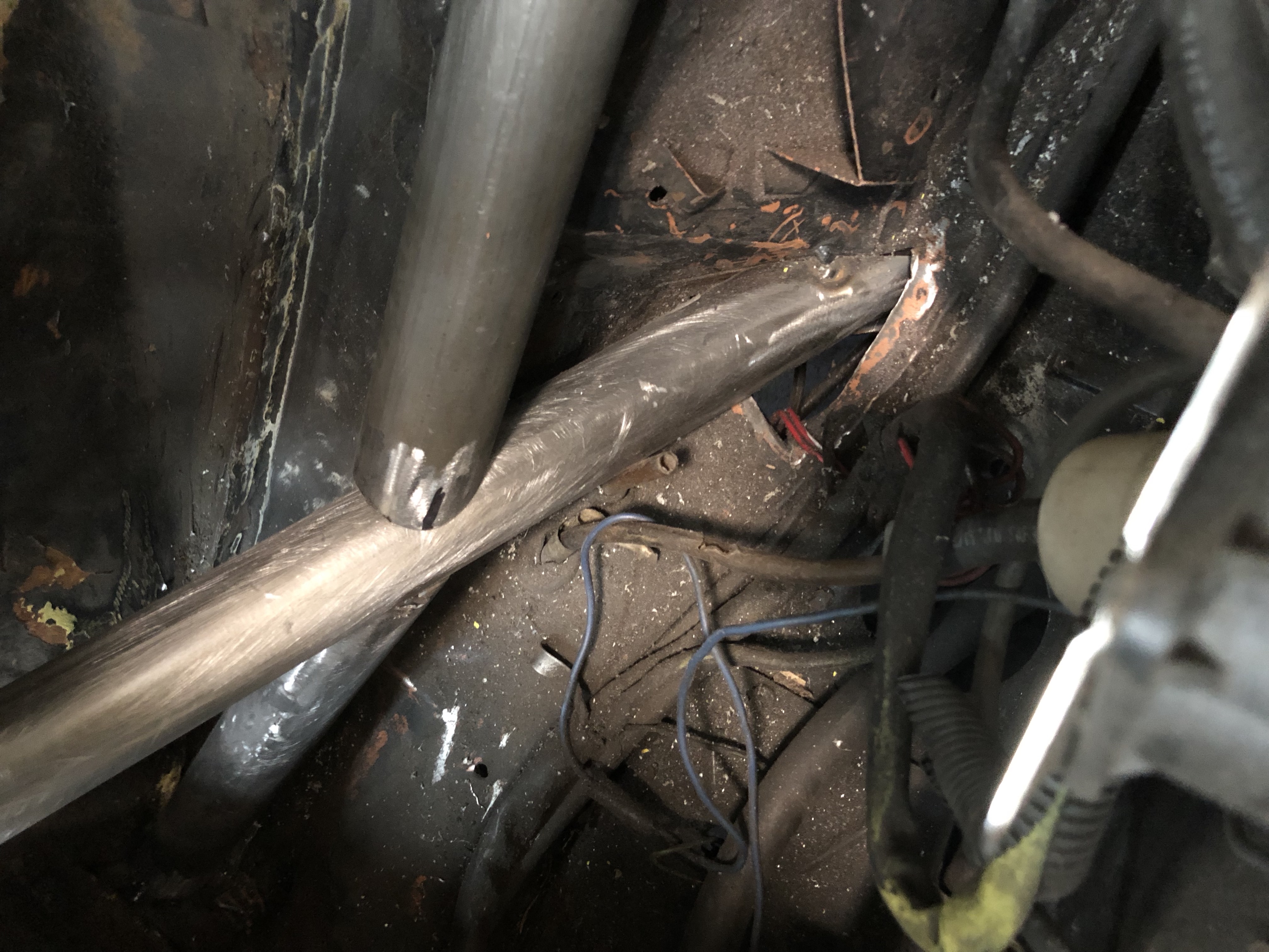

Working on a T45 cage by Custom Cages UK,
Attachments from rear main hoop to trailing arm, and another to shock tower, then triangulations.

Beechhousegarage   Working on a T45 cage by Custom Cages UK, Attachme...   Apr 20 2019, 01:48 PM

GregAmy   Is that cage above being built to a specific sanct...   Apr 20 2019, 07:34 PM
Beechhousegarage   Is that cage above being built to a specific sanc...   Apr 21 2019, 10:56 AM
GregAmy   For reference, I'm an SCCA scrutineer. What c...   Apr 21 2019, 02:15 PM
GregAmy   Just a quick follow up that I forgot to mention. ...   Apr 21 2019, 02:31 PM
Beechhousegarage   Thanks Greg! I may have been a little stubbor...   Apr 21 2019, 05:39 PM
