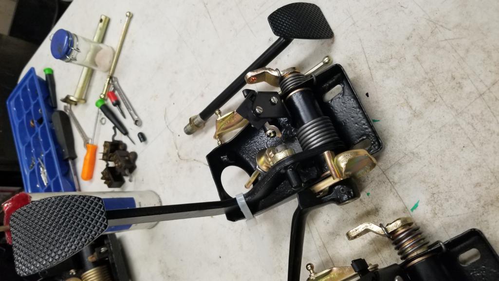

Interesting to hear of the degradation experienced by others. The original wood board in my early '73 seems to be in great shape every time I take it out. My pedal cluster is a mess by comparison, and is in need of a rebuild.
Wonder what the difference is? My car's chassis has logged 255,000~ miles and lived outside in the rain when my brother had the car 1986-1988~.

I found the plywood ones dry out and eliminate. The fiber ones restore.
Should be glad to do a legal set for you Pete.
