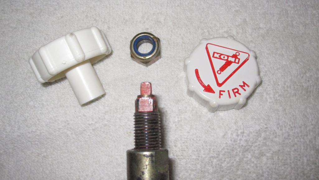

My car was converted to 5 lug before I purchased it. On the front they used early 911 parts with Koni adjustable inserts. There's an adjuster on the top of the shock shaft for rebound dampening this is obvious the question is: Did Koni also make an insert that is two way adjustable for the early 911? This would have a screw adjuster at the bottom of the insert for compression dampening? Don't want to pull them apart if they do not have this adjustment.
On the rear they used Koni 82K-1722 shocks and I know I have to pull them off to adjust them. Thanks, Tim |

tmessenger
other
Yes this is the style adjuster I have on ... Apr 22 2019, 02:57 PM
rhodyguy Paragon Products has the koni knobs for the fronts... Apr 22 2019, 06:44 PM
tmessenger
Paragon Products has the koni knobs for the front... Apr 22 2019, 07:59 PM
bdstone914 Koni inserts are only adjustable for rebound.
Br... Apr 23 2019, 09:02 AM
tmessenger
B... Apr 23 2019, 11:35 AM
