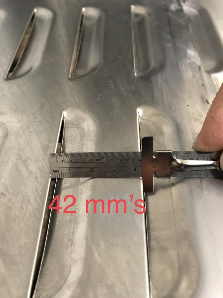

I’ve been meaning to share these pics as a small how to on installing this panel from Patrick Motorsports. https://patrickmotorsports.com/collections/...9146l-vrpan-pmp
A friend and neighbor has a 914 and I installed one in his car and he told a friend about it, except his friend wanted to add more lovers, so sure, let’s do it. |

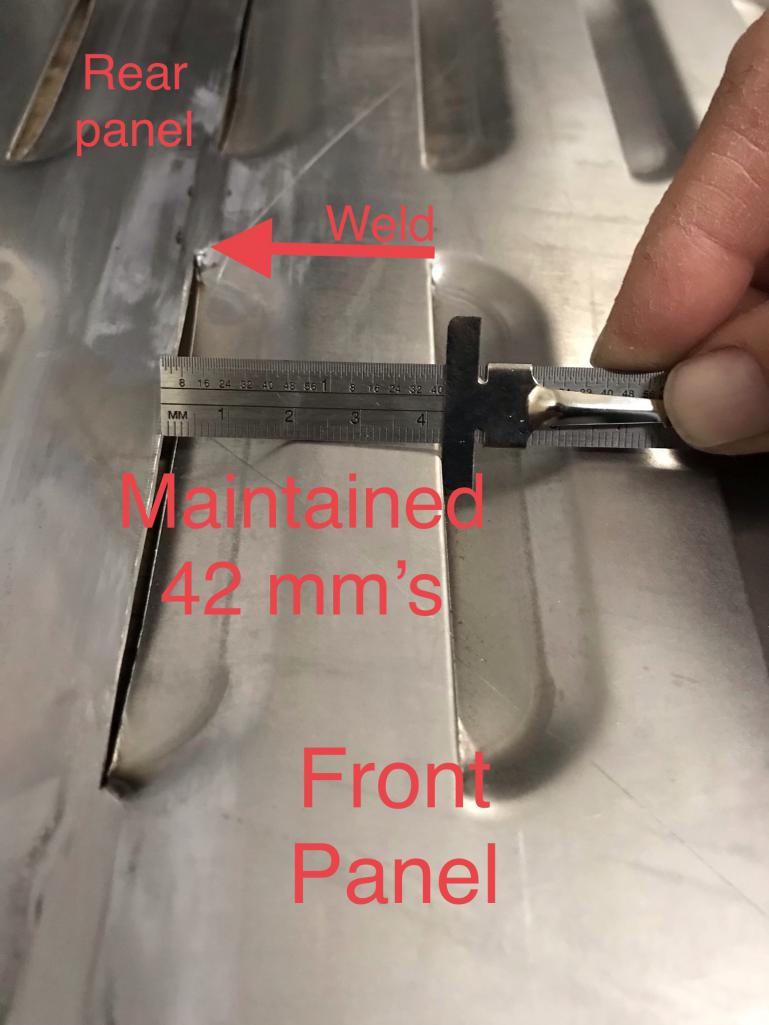

Trevor Gates TIG welded in. At this point you can either sand d... Apr 22 2019, 03:01 PM
