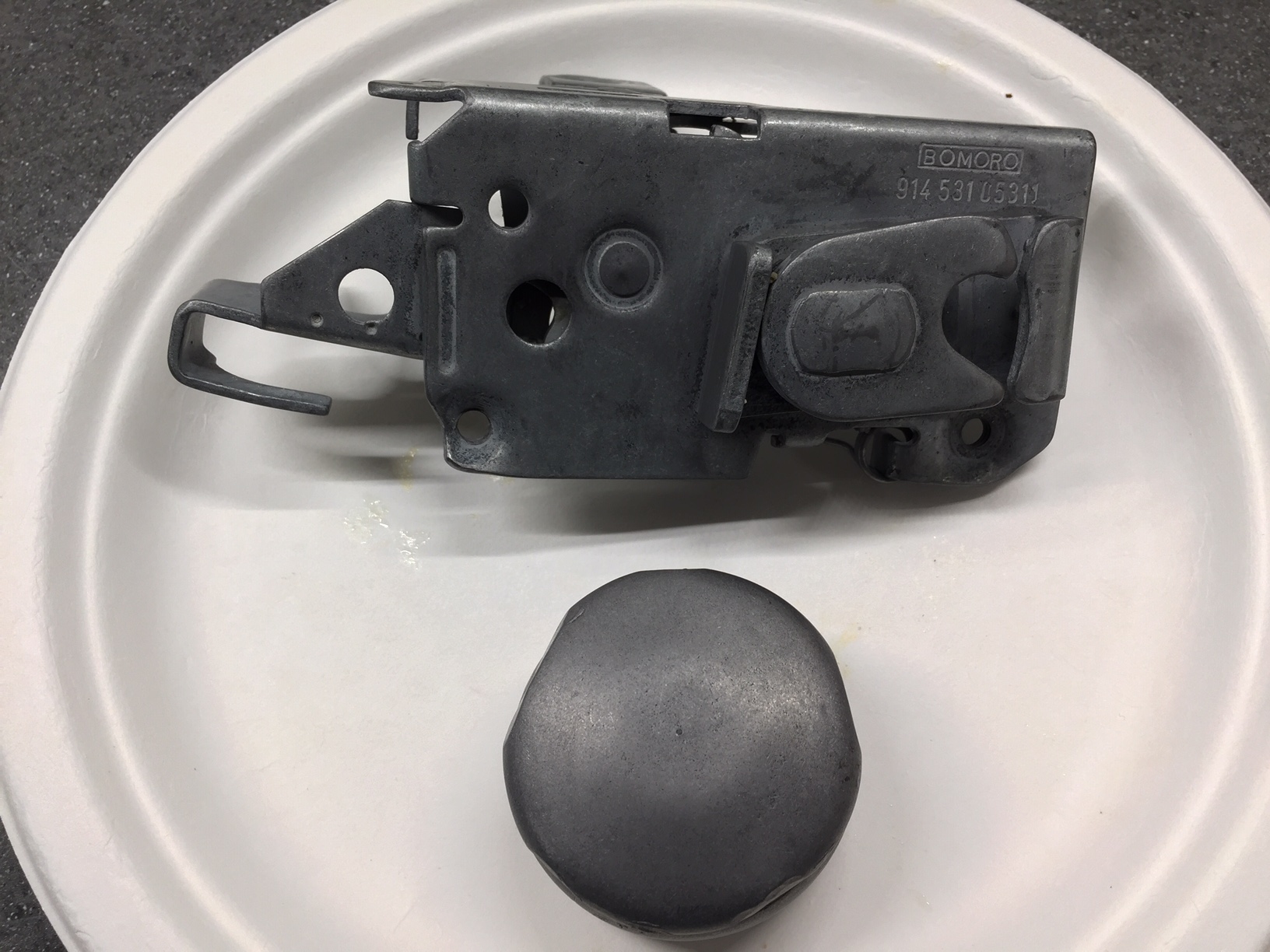

Does a good job cleaning up the parts but leaves a residue. I bought some kitty liter and home that will work to clean it up and give it a final polish. It’s loud but I found a place in back of the building so it’s not so annoying.

Here’s the parts after I rinsed off the kitty litter powder. No residue from the ceramic media. Left it smooth but dull. I’m guessing this will result in a dull finish if I zinc plate. @bbrock will walnut shells actually shine it up or am I chasing my tail.
Last year I bead blasted a 5 gallon bucket of hardware but left it in my garage so everything had a light coating of rust. I don’t have the patience to head blast again and I was hoping for a smoother finish than what results from blasting. Suggestions are appreciated.
