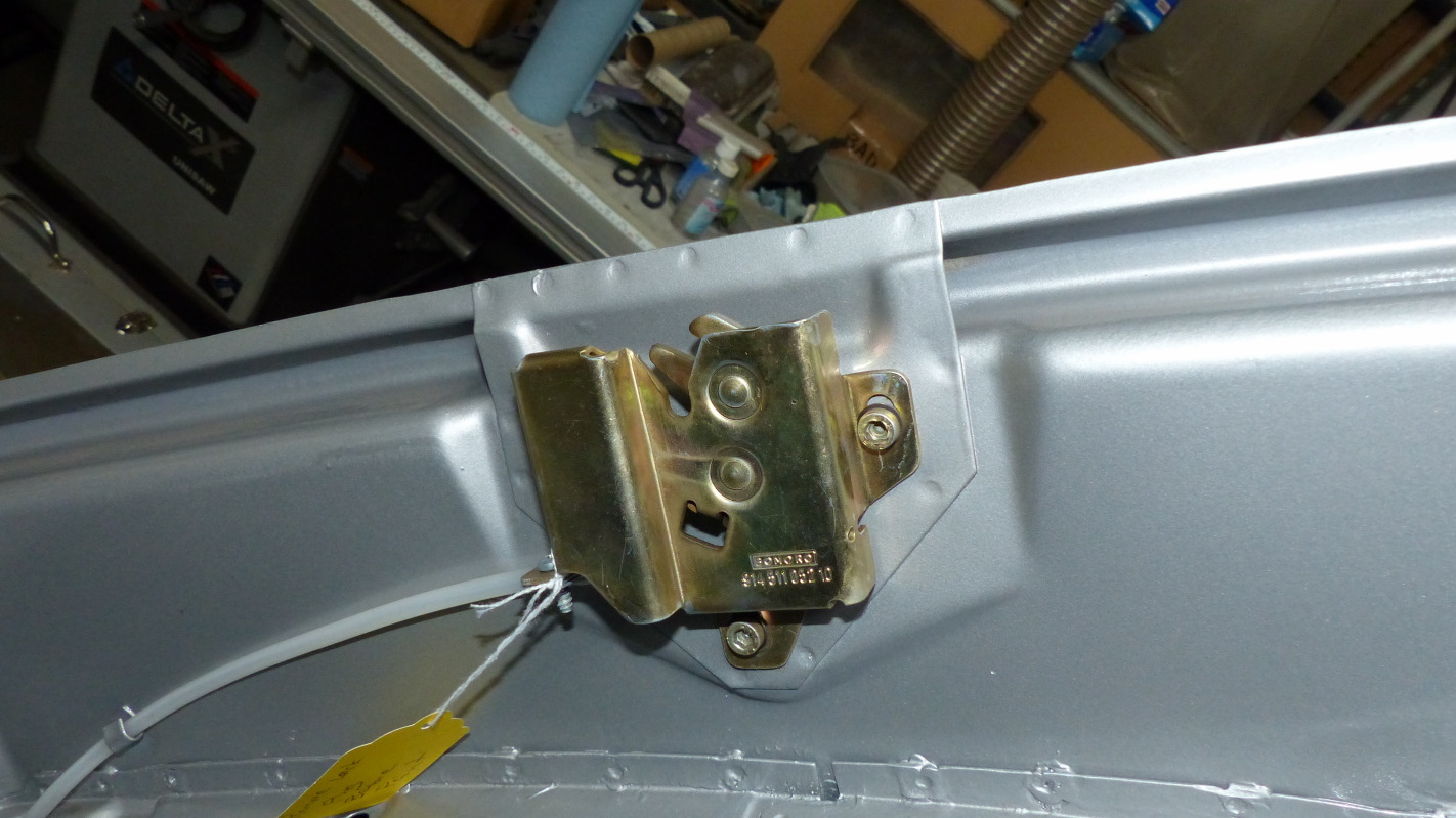

Quickest way to shine the big stuff like that is with a wire wheel. Should take less than a minute to polish off the latch. This was one of the earlier pieced I plated so not my best work, but not bad.
I used walnut shell mostly on stuff too small to wire brush. Walnut might polish the larger stuff, but I'll bet it would take a long time. As was already said, there are some good Youtube vids of people trying all kinds of things with different results. There are some good tips on prepping for electroplating in this one:
