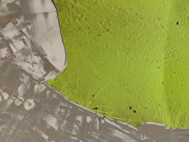

May 3 2019, 06:26 AM
#2
Senior Member ![]() ![]() ![]() Group: Members Posts: 740 Joined: 17-January 13 From: Winnipeg Member No.: 15,382 Region Association: Canada |
Per my email above, I snapped this pic of the front right wheel well. I've (painstakingly) scraped off the original stone guard with a putty knife and heat gun. The car was only Ravenna green once so the wheel wells were never repainted. As you can see, the factory sprayed the stone guard over what appears to to me to be bare metal and then sprayed the color over the stone guard. Unfortunately Wurth Canada only sells the stoneguard in white or black. I bought two containers of black for when the time comes (I will prime and paint over it), but might order white instead to be closer to the beige and so chipped paint is less noticeable.
