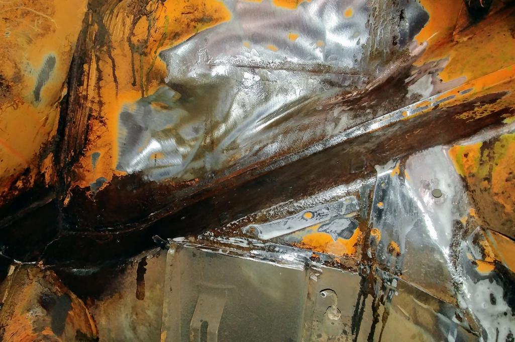

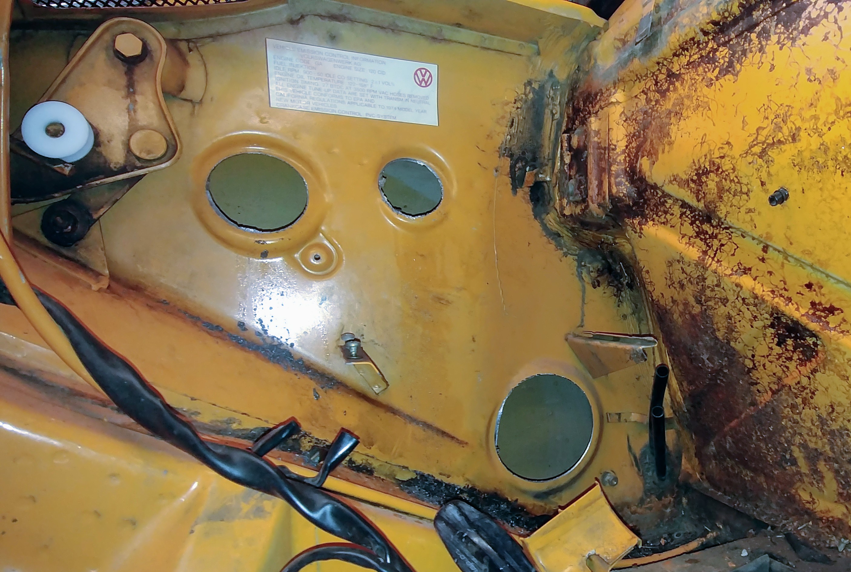

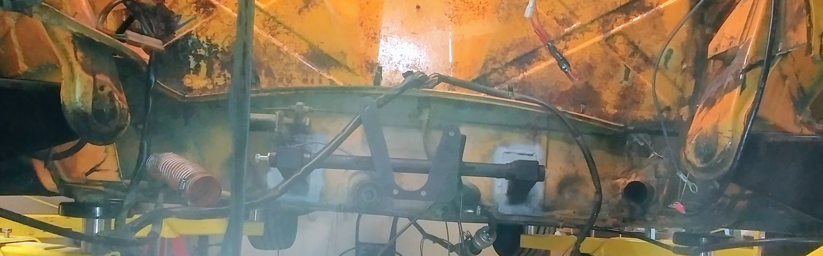

Spent some time drilling holes for the tank and then making the decision to replace the engine shelf. Also the battery tray is out along with engine mount in. Attached Image Attached ImageAttached Image
