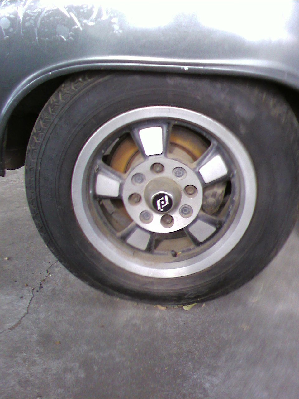

The original run of Rivieras like on mine were the correct 914 back spacing.
They would've been a 1972 run, because the original new sold dealer put them on & took off the 2L Fuchs when the OO got it in Nov 72. Rivs were an easy way to get the 5-spoke look without hub conversion back in the day.
It was later runs that went to one generic VW-914 back spacing, & IIRC that was on the later repops with the lip for balancing weights. Those will sit tight on the rear fenders unless "rolled".
