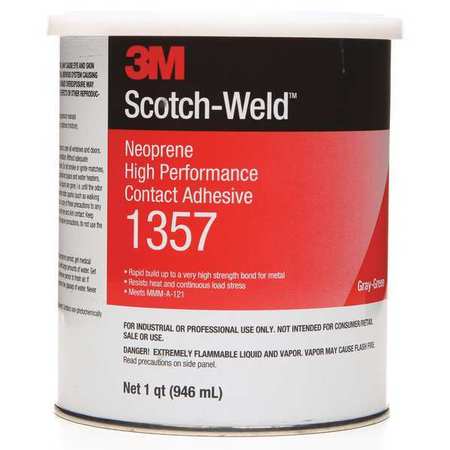

I want to glue on my sail panel vinyl but I've been warned to give the paint plenty of time to gas off. It's been about six weeks now. Is that long enough?

I would think so, but yes ask. Also make sure the glue has fully flashed or you risk bubbles.

I would think so, but yes ask. Also make sure the glue has fully flashed or you risk bubbles. @Mikey914 Can you explain what you mean by fully flashed? |

I would think so, but yes ask. Also make sure the glue has fully flashed or you risk bubbles. @Mikey914 Can you explain what you mean by fully flashed? I've become more if a fan of the Scotchweld product. You brush it on, but really you can make a bigger mess with rattle can stuff. You can pot it if you have a gun, butI brush. Others have mentioned the flashing. Basically the stinky solvent smell will be gone and it will be sticky. Yes it's usually longer than directions say. Attached image(s)
