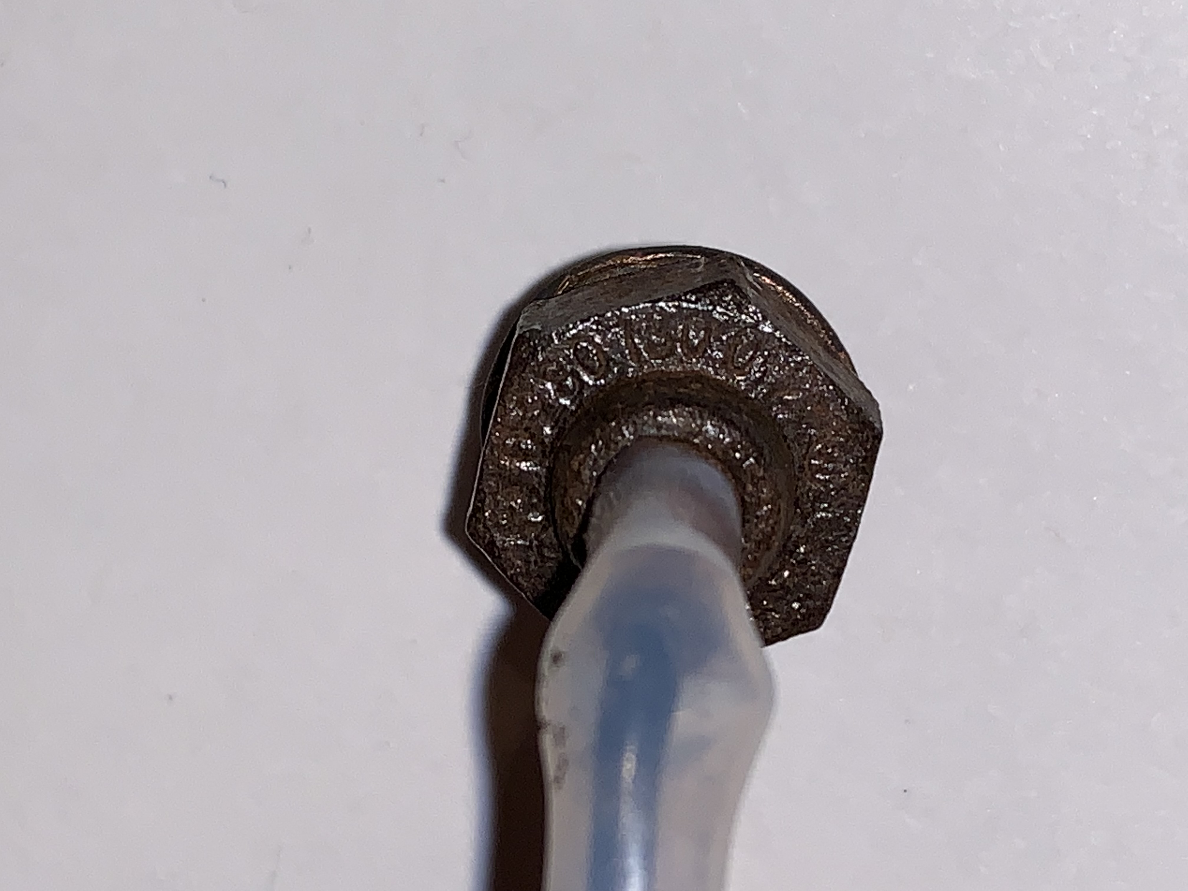

Senior Member ![]() ![]() ![]() Group: Members Posts: 1,385 Joined: 9-June 18 From: boston Member No.: 22,206 Region Association: North East States
Out of curiosity - what is the part number on the CHT that you took out? The car was stored in 84, with 20K miles, nearly everything in the car was original - I am assuming the CHT was original as well. '74 2.0L, ______ Porsche #______________Bosch # '74____311 906 041 A_________0 280 130 012 '73____022 906 041 A_________0 280 130 017 I brushed the rust as gently as I could, here are some pics of the numbers. Is that a "041" is see there?????? Not sure........ Looks like it _could_ be one of those????? (IMG:style_emoticons/default/confused24.gif) (IMG:style_emoticons/default/confused24.gif) (IMG:style_emoticons/default/confused24.gif) |
