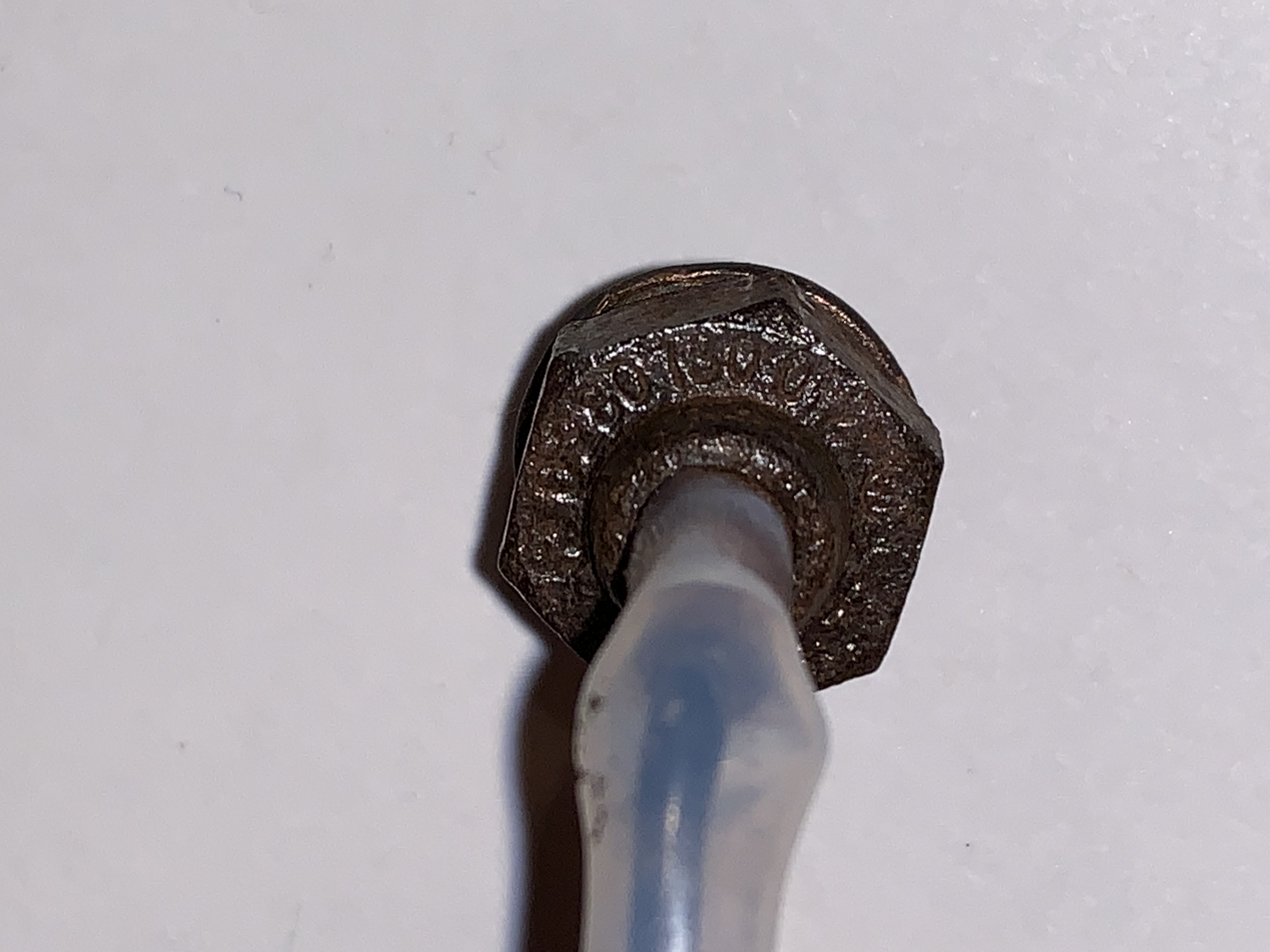

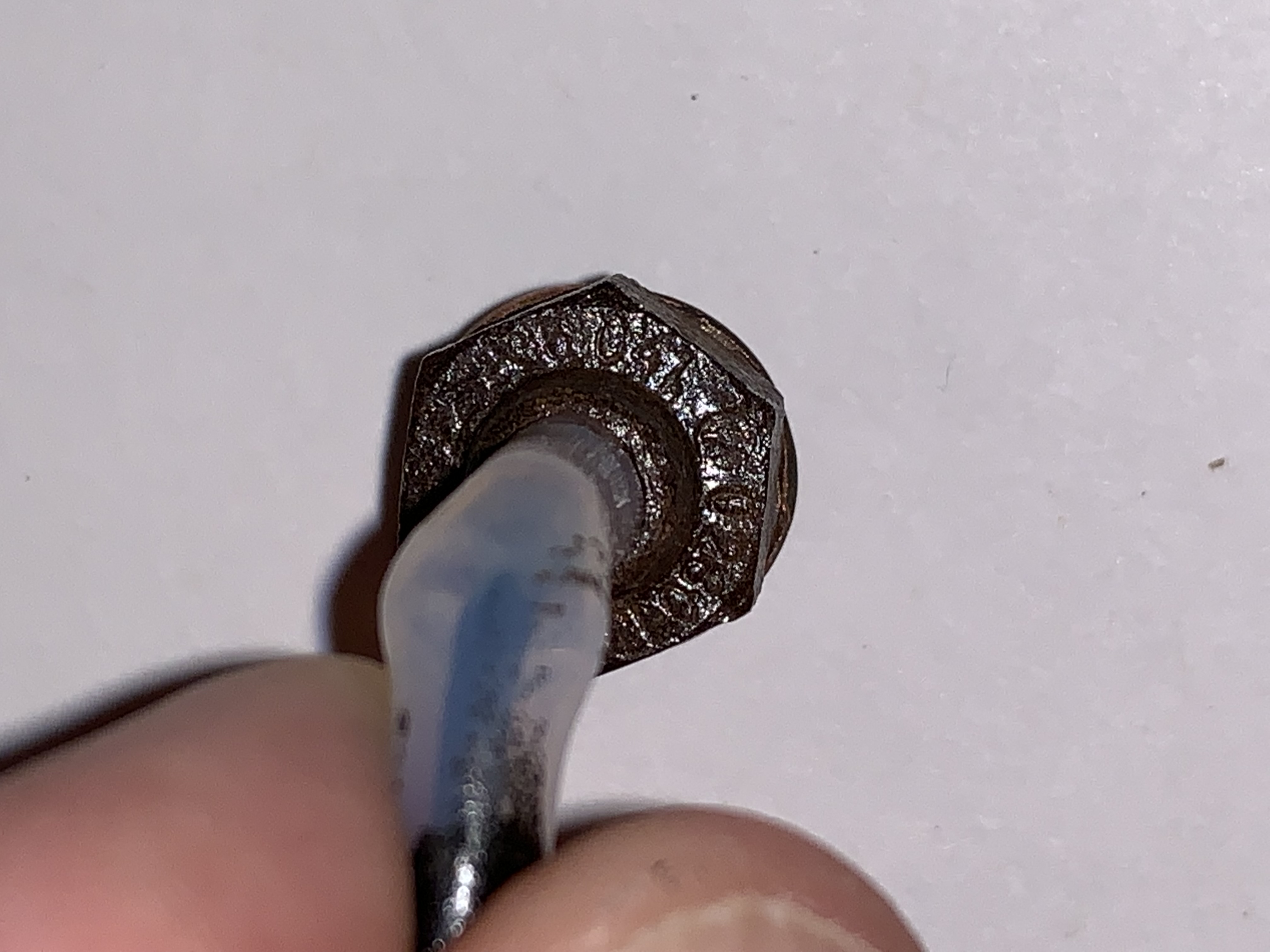

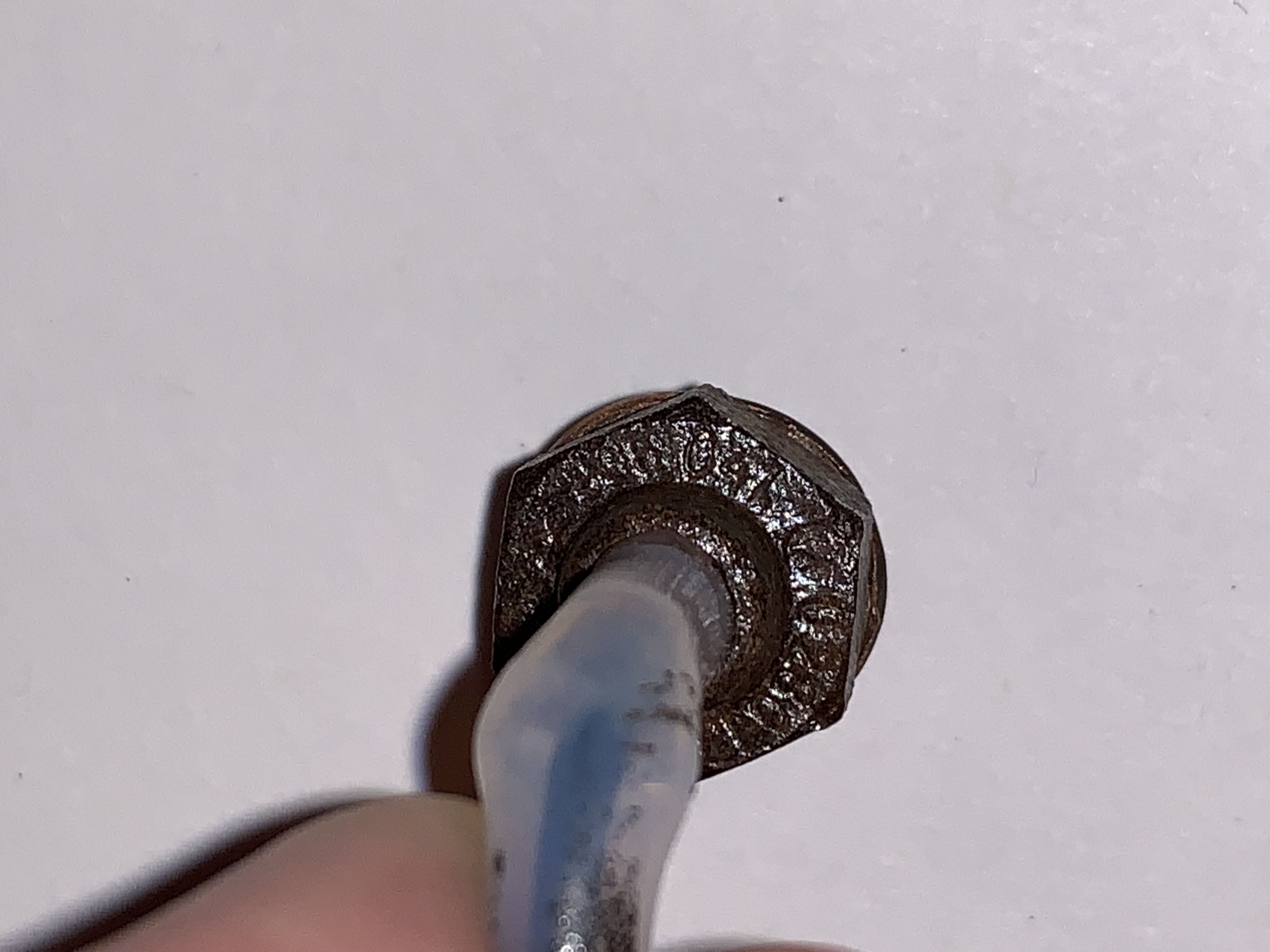

______ Porsche #______________Bosch #
'74____311 906 041 A_________0 280 130 012
'73____022 906 041 A_________0 280 130 017
I brushed the rust as gently as I could, here are some pics of the numbers.
Is that a "041" is see there?????? Not sure........
Looks like it _could_ be one of those????? confused24.gif confused24.gif confused24.gif

Did the new CHT sensor not work correctly? Or did you just put the old one back in to test it?
ctc911ctc
I took the old one out after I took the plenum out. At that point I was able to get a wrench on it and replace it. I had a few failures going on, vacuum was bad and a cht was open. Rich and lean at the same time!
