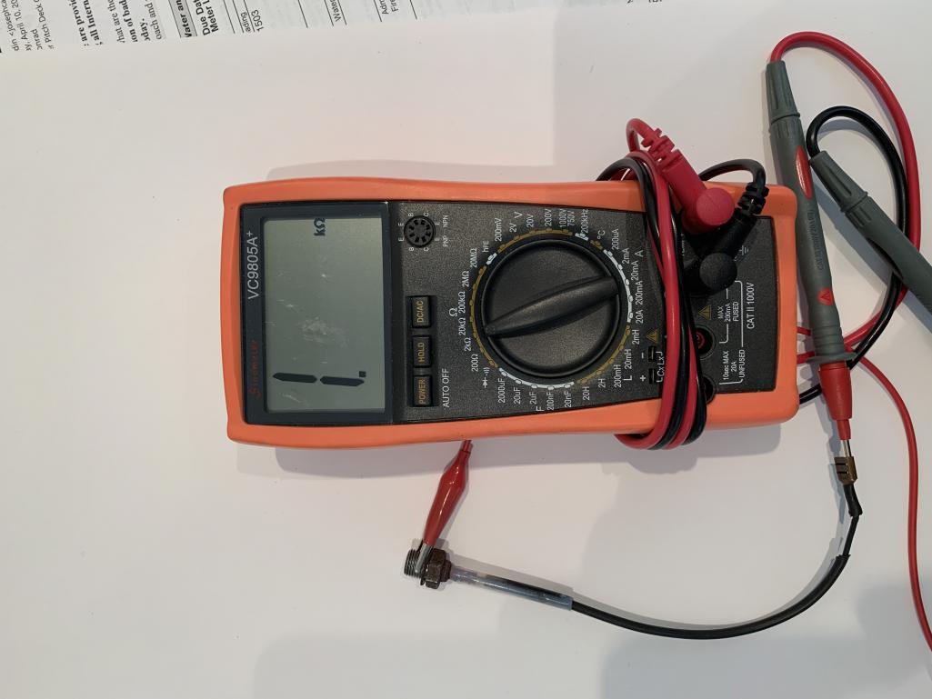

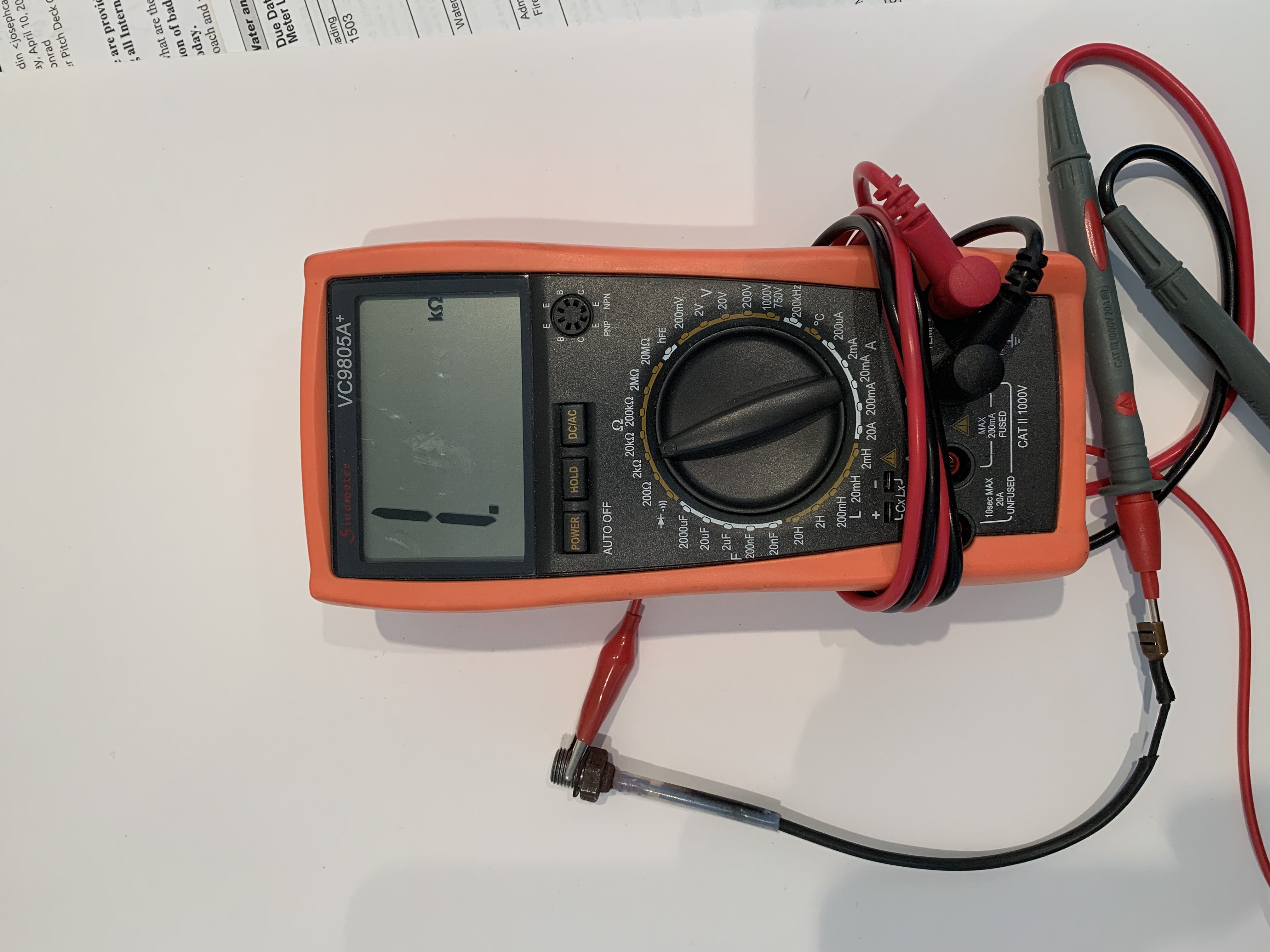

When I pulled the Plenum (chasing the too rich issue) I was able to remove the CHT. Could not get a wrench on it prior. I replaced it. As I wrote above; after I got the fixed plenum back into the car, the idle adjustment screw had no effect. This according to the all knowing Anders, is the result of a car running too lean. which also caused the popping....
So I went back to the old CHT (I had not tested it, just changed it because of it's age and it is on near everyone's list of things to replace) and I found that it was open - No Good. Ahhhh, so this could be why the car is now LEAN!!!!!

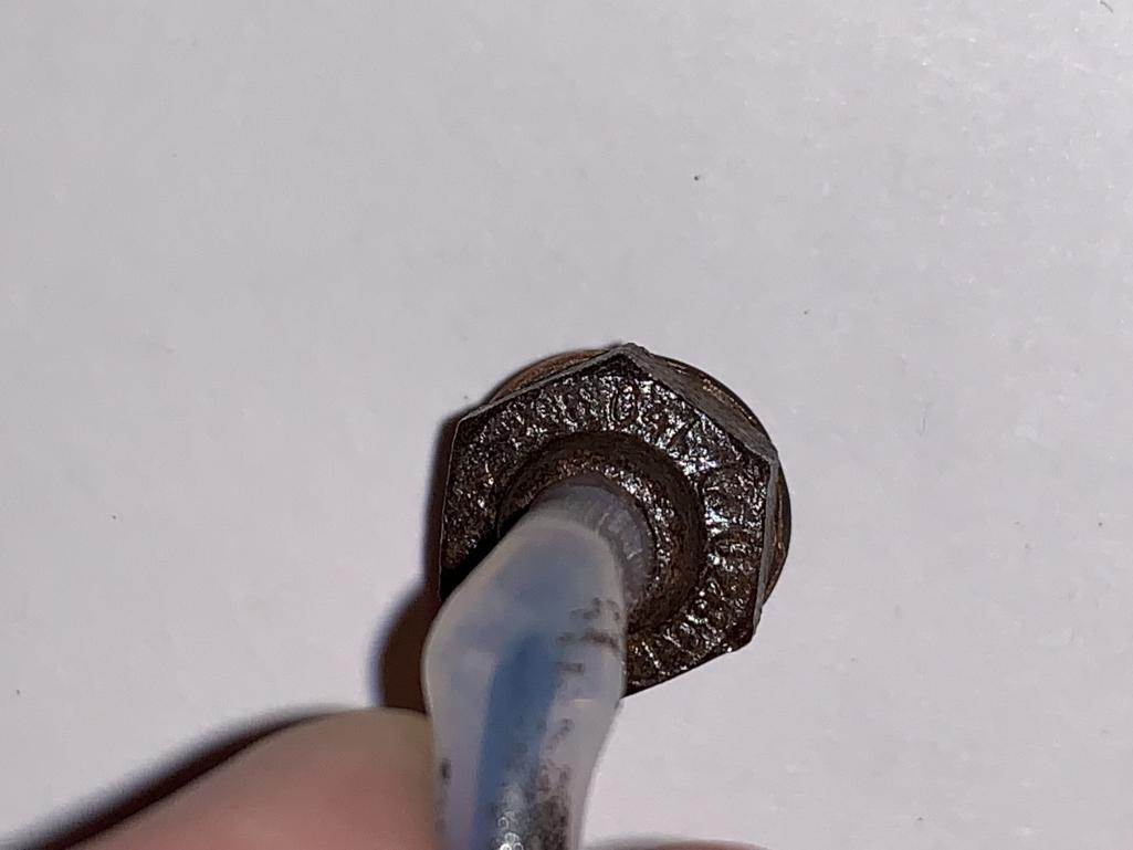

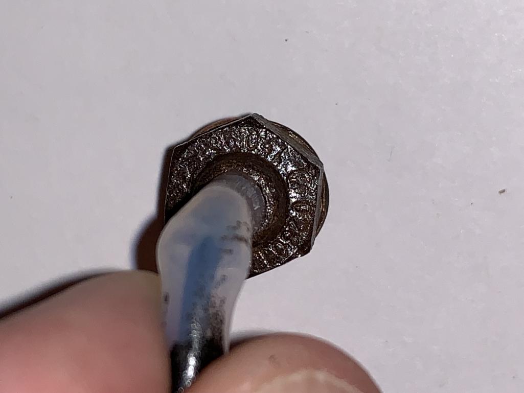

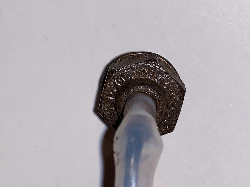

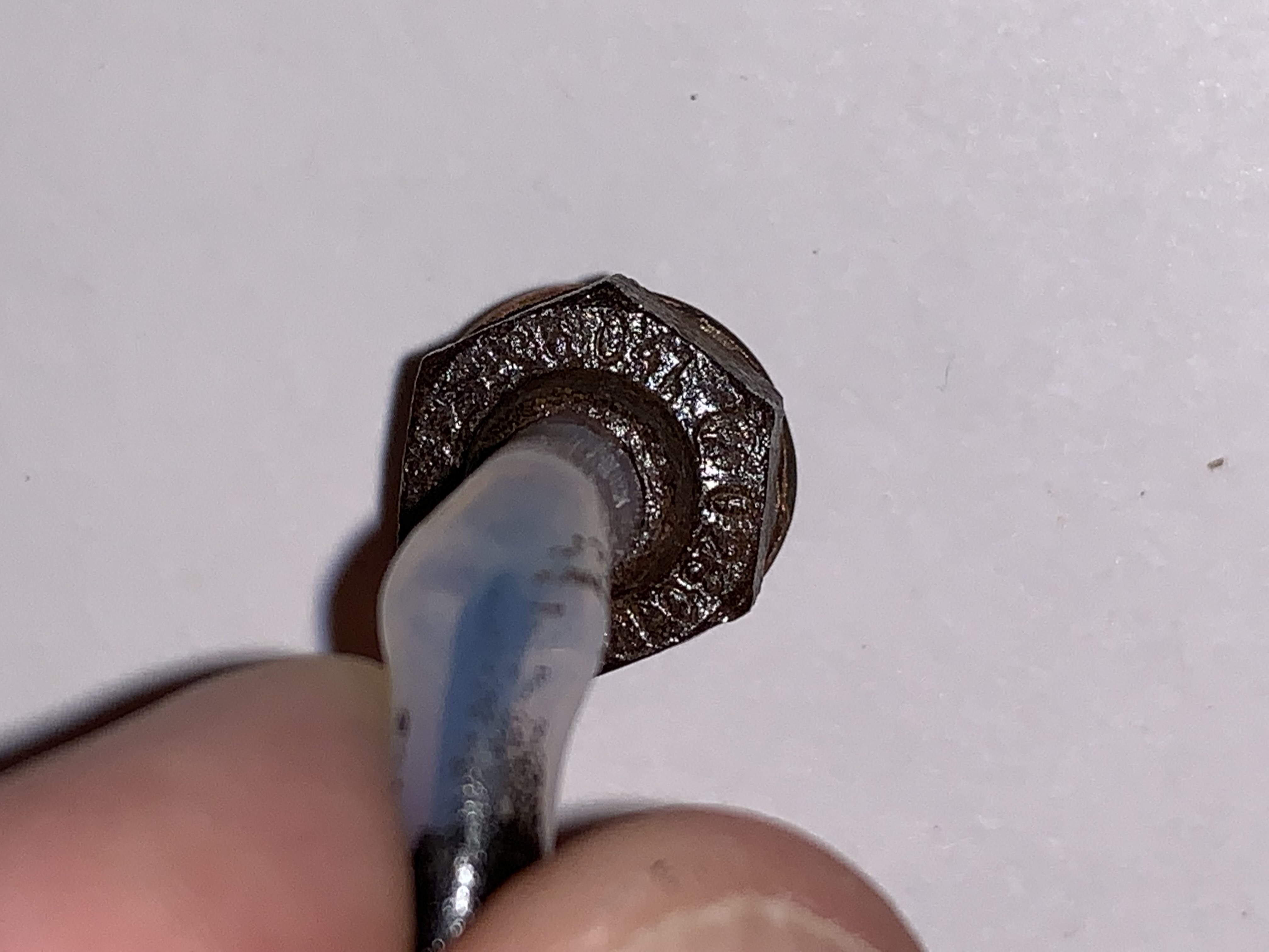

The car was stored in 84, with 20K miles, nearly everything in the car was original - I am assuming the CHT was original as well. '74 2.0L,
______ Porsche #______________Bosch #
'74____311 906 041 A_________0 280 130 012
'73____022 906 041 A_________0 280 130 017
I brushed the rust as gently as I could, here are some pics of the numbers.
Is that a "041" is see there?????? Not sure........
Looks like it _could_ be one of those????? (IMG:style_emoticons/default/confused24.gif) (IMG:style_emoticons/default/confused24.gif) (IMG:style_emoticons/default/confused24.gif)

I took the old one out after I took the plenum out. At that point I was able to get a wrench on it and replace it. I had a few failures going on, vacuum was bad and a cht was open. Rich and lean at the same time!

So the CHT is just a thermister.
It is easy to check with a DVM and the corresponding temperature. The resistance values are on the B Anders site.
What invariably happens is that over time the ground connection gets oxidized or....the wire contact gets loose.
Without a good ground to the CHT the car will run like crap....or not run at all if there is no ground.
My quess is that the oxidation between the CHT and the head oxidized and when you broke it loose then put it back in you cleaned the ground connection up.
I think McMark was making one with a dedicated ground...I put it in my old car and never worried about it again. 914 Rubber might be making them now.
Test the old one anyway just to be sure.

In this thread there is a picture of me testing the thermistor Mr.! grin.. I was able to get the OHM meter to register metal-to-metal (base of the CHT thermistor) zero ohms. In the picture it is WIDE open! new one installed and working great,
Thanks for the help! car is running good, first time since 1984!
