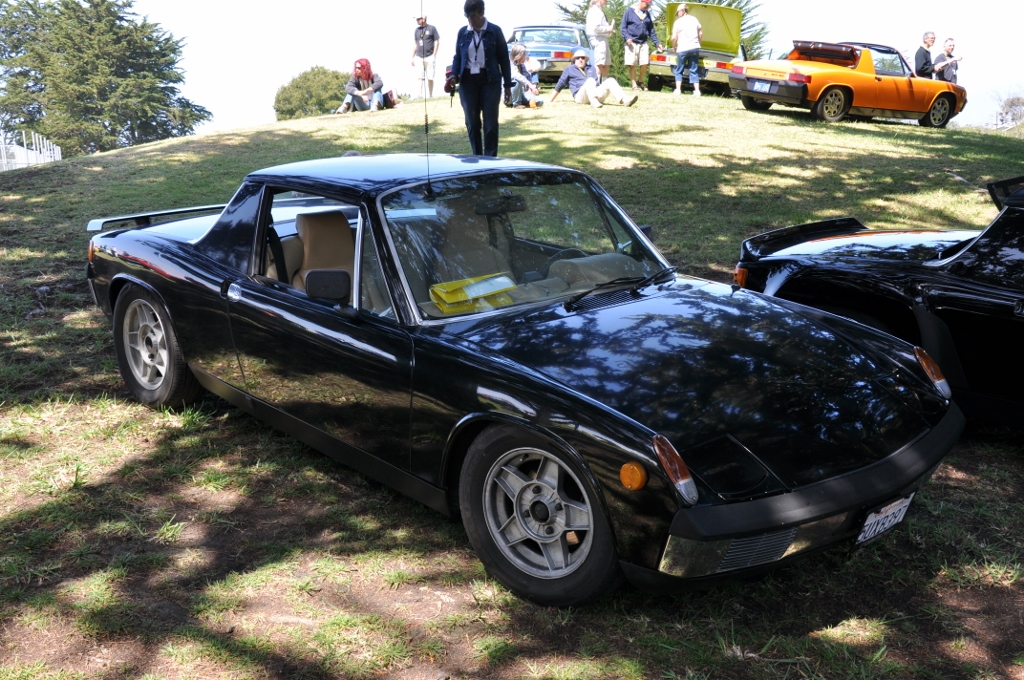

Other than the factory wheels what are available in either 5.5 or 6 inch width with correct back spacing for a stock body 914?
Thanks,
Mark

betz   I was wondering, I'm looking at the 4x130 Enke...   May 15 2019, 12:09 PM
Chris914n6   For 205 tires you will need a 40mm offset in a 5.5...   May 16 2019, 12:19 AM
betz   For 205 tires you will need a 40mm offset in a 5....   May 16 2019, 10:18 AM
Racer   if willing to run a 6.5x15, you could source some ...   May 16 2019, 06:23 AM
71six   What are the actual specifications (backspace, off...   May 16 2019, 06:31 PM
thelogo   I would go for the vto wheels But its a little ...   May 16 2019, 08:13 PM
sixnotfour   I would go for the vto wheels But its a little...   May 16 2019, 08:19 PM
betz   I would go for the vto wheels But its a littl...   May 17 2019, 10:03 AM
71six   [quote name='sixnotfour' post='2714461' date='May...   May 17 2019, 11:18 AM
betz   What are the chances of the VTO 7"x16...   May 17 2019, 02:57 PM

sfrenck   Guess wheels in the sixnotfour pic are these HPD ...   May 17 2019, 07:44 AM
dr914@autoatlanta.com   yes these were the ones I was writing about, guy s...   May 17 2019, 08:08 AM
