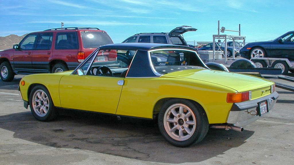

Years ago I had some Panasport wheels (Minilite style), which were awesome. 15x7 4x130 as I recall, and I ran 205 tires. Loved that setup but not sure how available this type of wheel is anymore.

campbellcj   Years ago I had some Panasport wheels (Minilite st...   May 17 2019, 04:31 PM
Larmo63   In my never to be humble opinion, stock 914 Fuchs ...   May 17 2019, 08:23 PM
campbellcj   Actually I think the Panasports were 15x6   May 17 2019, 09:17 PM
