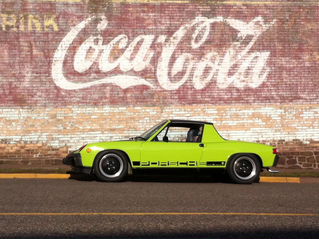

rick 918-S   I like the Enkei 92 style. They are very light.   May 18 2019, 07:53 AM
