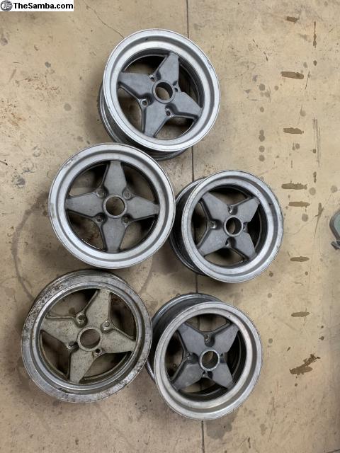

Other than the factory wheels what are available in either 5.5 or 6 inch width with correct back spacing for a stock body 914?
Thanks,
Mark
sixnotfour
post May 20 2019, 04:02 AM
Posts: 11,422
Joined: 12-September 04
Member No.: 2,744
https://www.thesamba.com/vw/classifieds/det....php?id=2280414
15x6

sixnotfour   https://www.thesamba.com/vw/classifieds/det....php...   May 20 2019, 04:02 AM
rhodyguy   A little curb rash. <_< better off buying ...   May 20 2019, 08:33 AM
